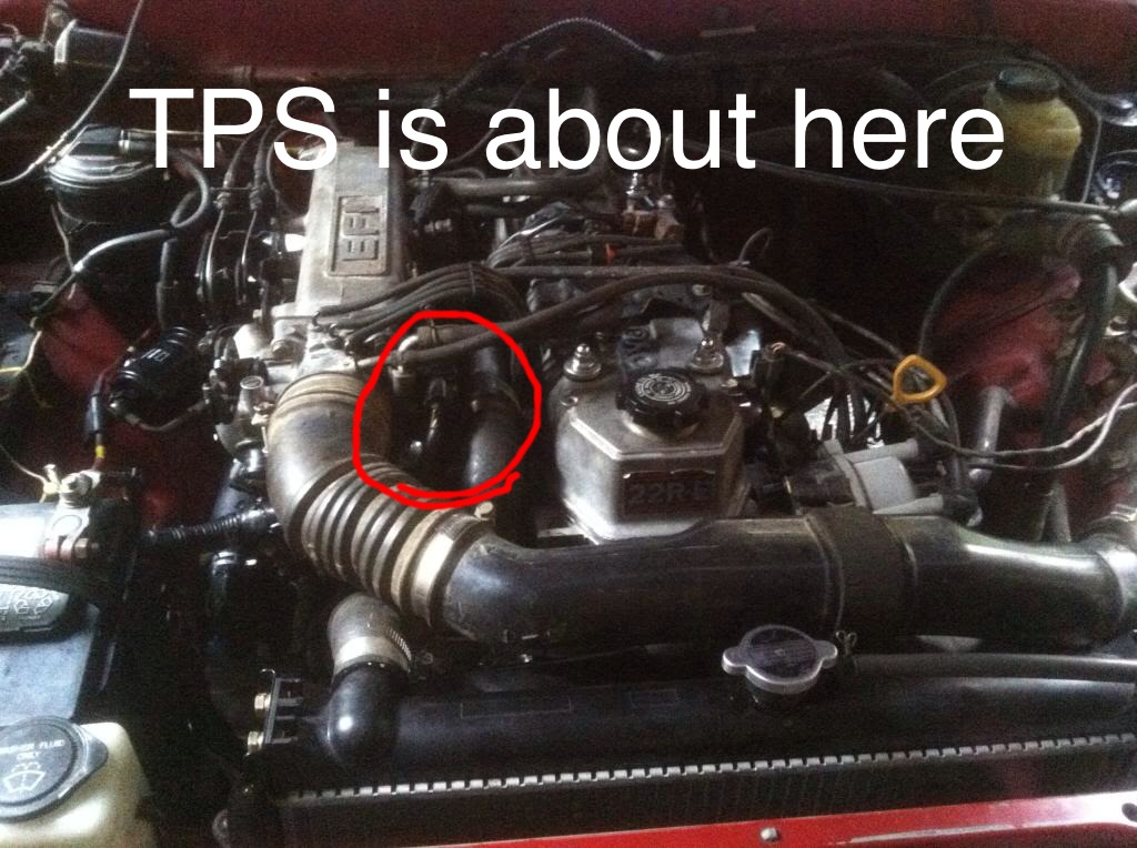

Didn't you ever see Office Space. We all need to file our TPS reports. But on a serious note. It is your throttle position sensor. It mounts on the throttle body and has a plug that hook up to the front of it. I can't find an exact pic of the location at the moment. But it is about here secured to the side of the throttle body Name:  D3909069-A996-479F-91DB-265154A1CAB8.jpg

I'm an idiot. I just saw its a 3.0 not 22re. Do disregard picture location. Haha. Need more coffee
