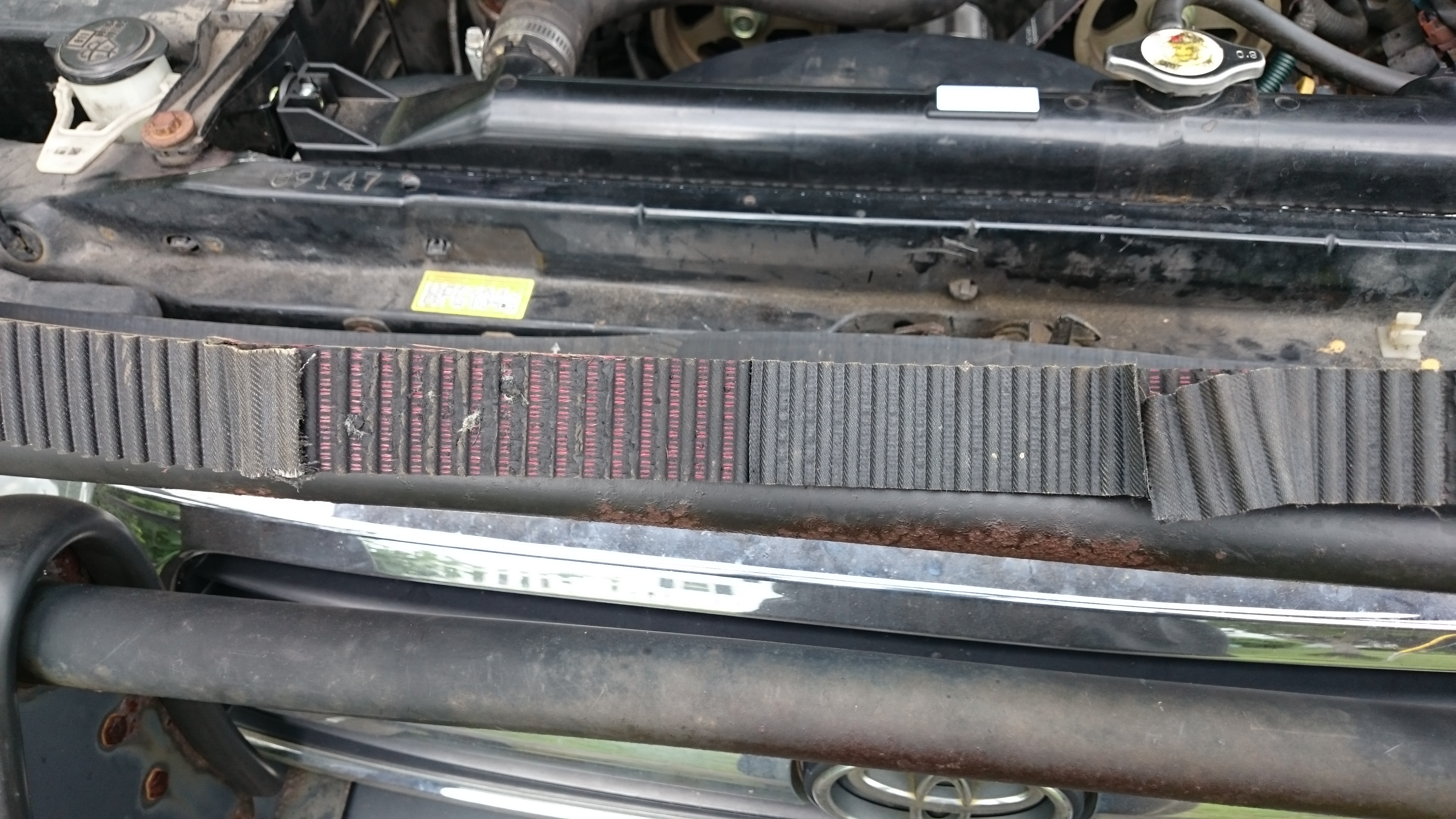

Hello all, I need some insight here. One of my T4R is doing something mysterious. It is a 99 3.4L with 184K miles. When I bought it, the timing belt had snapped. I changed the timing belt, WP and the pulleys. After 4 days, the vehicle wouldn't start. Just kept winding. After doing all the preliminary checks, I found out it was off timing. After taking the whole thing apart, I found out my timing belt had stripped (see picture). So I changed the timing belt again with a new Aisin hydraulic tensioner. I put it all back together and everything was hunkie durie for a few day until today after work, it did not want to start. It finally did but it wasn't "purring." I got home and checked the timing and lo and behold, it had jumped THREE TEETH. Now I am stumped. Any ideas here. This is not the 1st T4R that I have changed the timing belt. I have a few of them. Any insight here would be appreciated.

Did you turn all the idlers and water pump by hand and feel for roughness, or play??
Could be a bad bearing that locks up periodicly. Even new stuff sometimes fails.

Unfortunately, if it's stripping teeth off the belt, it means that one (or both) of the cam drives is encountering some excessive drag. The tensioner, idler, and waterpump all run on the back side of the belt and don't stress the belt in the same way. If they lock up or drag too much, they're just going to start squealing against the belt instead of stripping teeth.
With the belt off, try putting a wrench on the cams and turning them around. They will have a fair amount of resistance as they open and close valves, but it should move smoothly between valve openings.

You are right Jomoka. I actually did that already and the cams have more than usual resistance especially the driver's side. What could cause the cams to have excessive resistance?
