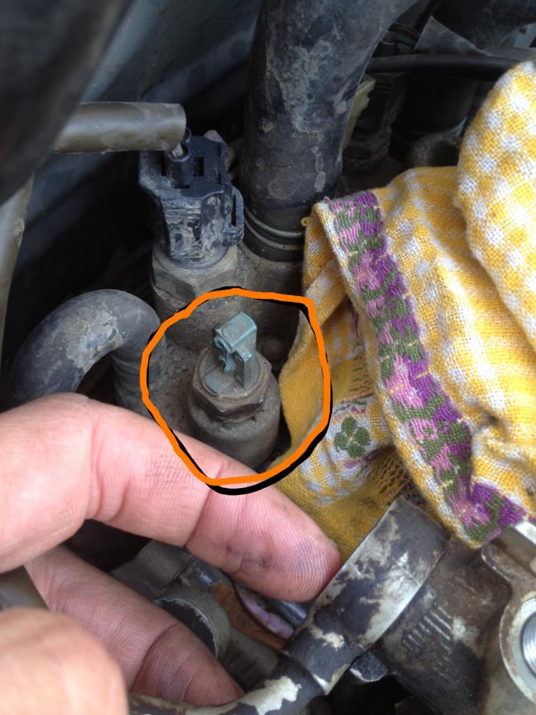

Another question/issue. I broke off the two vacuum nipples on the piece in the photo below when taking out the fuel pulsation dampner. I took the 'sensor' out and found that it goes into a coolant passage, has NO thru-holes (it is essentially a plug), there are NO electrical connections, and the two nipples seem to connect directly through one-another. Is there ANY reason I cannot just splice these vacuum lines? This 'sensor' just seems to be a plug with a fitting on top that directly connects the two fittings.
Does anyone know what this is and whether I can bypass it safely?
Thanks much!

I believe fpd is copper o rings. I am doing/have done all of this as we speek. Have motor pulled out. That blue thing is like a temp switch. I cant remember what its called. U need it. I broke the same thing off. Getting hasty and ripping things apart. Find one a junk yard. There like 50$ or more at stealership. Might as well change ire plugs and wires while there accessible. I did every seal and gasket there is on this thing. Waiting on Doug thorley headers right now before it goes back in.

Search for TVV (Thermal Vacuum Valve) (or BMSV - Bimetallic Switching Valve). Welcome to the club; many of us have broken one of those nipples. Some have managed to super-glue it together, but on mine the plastic was so crumbly the fix did not take. A junk-yard one would be excellent if your plan is to replace it again within the next 12 days. (If yours is falling apart from age, how good is one on a junk vehicle?) Otherwise, spring for the $65 and get a new one.
It connects the canister to the throttle body. When the throttle opens it sucks the accumulated fumes out of the canister. The engine doesn't like doing that when it's cold, so the TVV shuts off until the engine is warmer. If you jumper the two lines you should have cold idling trouble, but who knows? If you don't connect them at all the canister will fill up and you'll smell gas on the passenger side.

This forum is the best thing since sliced bread. Searched TVV - 1st thread that comes up has the PN right there. Thanks MudHippy! (https://www.yotatech.com/forums/f116...s-3vze-224860/)
I'm just gonna spring for the new one... just gotta make sure I don't break it re-installing. It's pretty tight in there. Any tips on how to get it back in. The only way SEEMS to be with an open-ended wrench, but there is hardly any room to swing. Probably a patience job.
