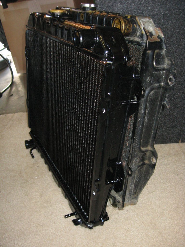

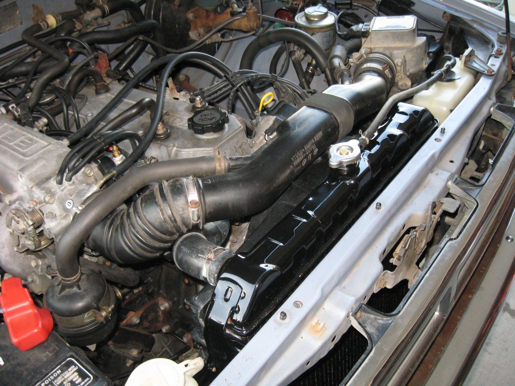

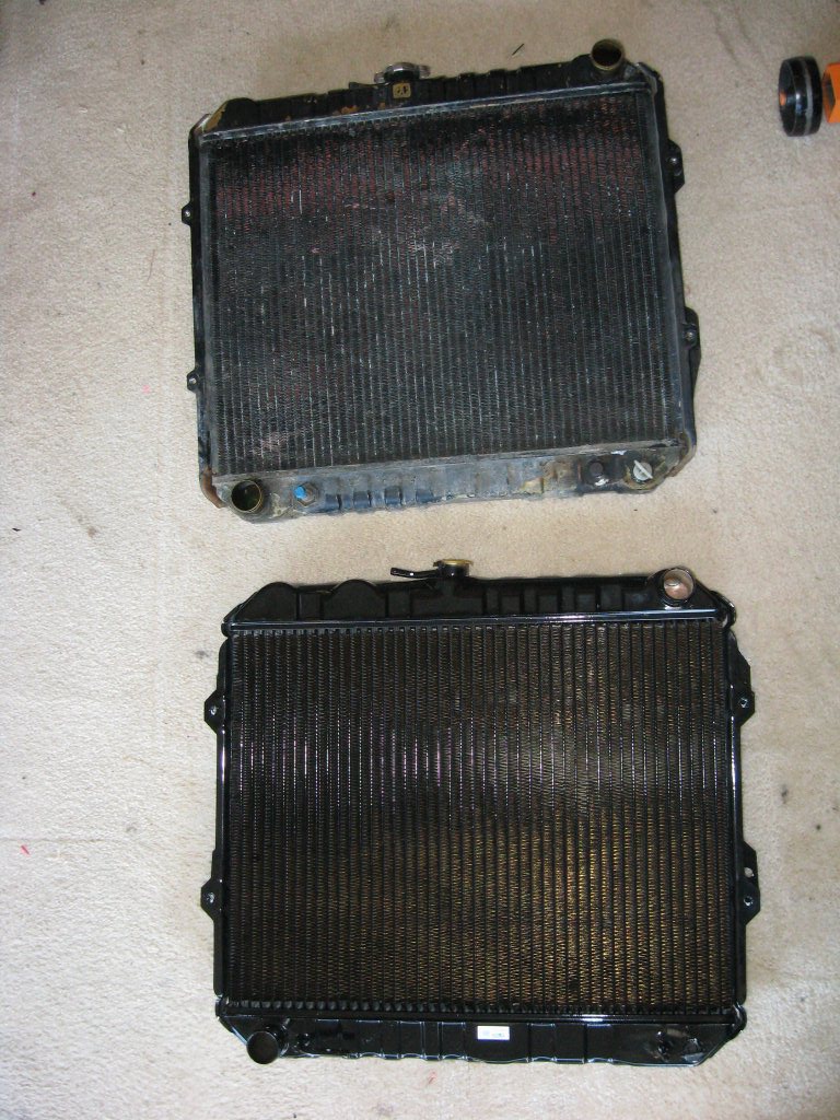

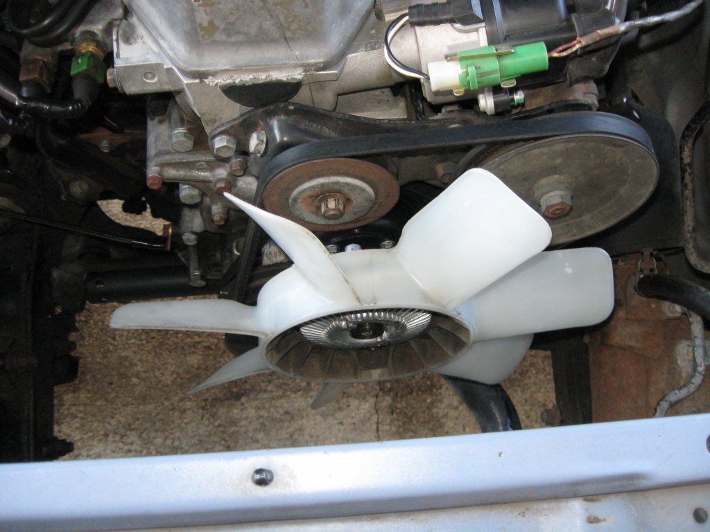

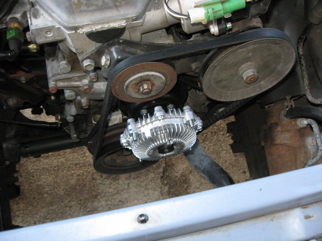

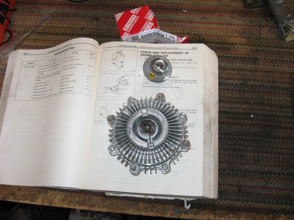

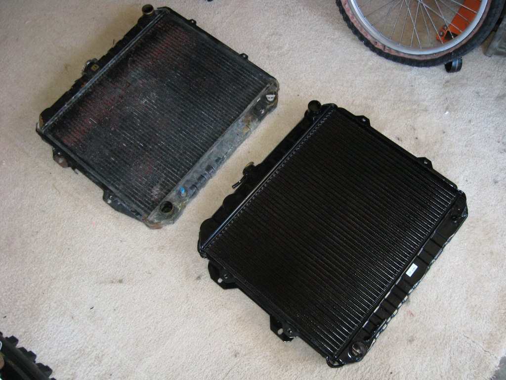

My original radiator looked pretty beat up, the fins were very brittle and would crumble if you looked them funny. I wasn't happy with my engine temps while climbing up mountain roads at low speed. My gauge would read 3/4 the whole time. So I bought some new stuff.
Parts:
CSF 2314 - 3 core radiator form radiator barn.
New OEM dual stage thermostat
New OEM fan clutch (my old one wasn't working at all)
The CSF 2314 bolted up just fine, no fitment issues whatsoever, here are some comparison shots of the CSF and my stocker.

Originally Posted by huntsonora
How are the temps?
My Autometer gauge hovered right around 190 during my test drive cruising around town.
My stock gauge never moved from this position.

I have yet to do any slow mountain roads, but I did take it up the Cuesta Grade near San Luis Obispo (SOCAL), its a pretty long & steep 7% grade. My auto meter gauge peaked at about 205 pulling 4th gear 55MPH the whole way. The stock gauge was reading hair over half way. (it was bout 75-80F that day too)
I'll let you guys know my mountain climbing temps when the time comes.
