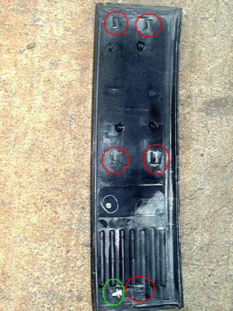

Is there some trick to remove those pannels on 1st gen 4runners that are directly behind the doors?
Attached Thumbnails 1st gen 4runner sail panel removal-4runner-sailpanel.png

yep there is a trick .
If you push the bottom forward , it will release the bottom clip . push up and it will release the top 2 clips , then pull down and release the sail panel .
problem is , installing it back on the clips is next to impossable ... and I have never been sucessfull in removing the clips with out breaking them .

You can save a couple of the clips..
they will slide off in one direction, I will get some pics to explain..

Yep, push forward on the bottom to release the bottom clips then push up to release the top clips. I found the drip rail on the roof precluded raising the panel high enough to free he clips fully, but was able to pop them loose with a little pressure. I re-used all the clips by lightly gluing them into the panel:
Also replaced all the rubber flaps on the vent with some pieces of rubber inner tube cut to fit:
