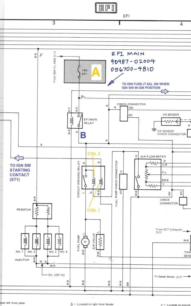

Please don't mess with that C.O.R. just yet
A problem well-stated is a problem-half solved already. 22RE? (No info on signature).
By "starting" problem, does mjans813 mean
1) Starter has trouble cranking? Or
2) Does engine crank but there is no combustion.
If 1:
C.O.R. has absolutely no effect on that. Don't mess with the C.O.R. See cranking system explained on my sig. See C.O.R. explained here.
If 2:
Possibly no fuel. Then, check fuel system including C.O.R., and injection system
Also possibly no spark. Then, check ignition system.
Originally Posted by Austin Marr
Can you hear your Fuel Circuit Opening Relay clicking off once you let off of the ignition? if you dont hear any clicking after letting off the ignition i would check that circuit opening relay (COR)
Originally Posted by mjans813
Just looked up what that was, and it sounds like the problem. Would I have to replace that? Or would there be an easier fix?
If having trouble cranking the starter, you would actually still hear the C.O.R. click (contacts closing) when you put in "start" position. When you release ign switch while there is no combustion, because there is no airflow C.O.R. will de-energize, making that other click. C.O.R. does not affect cranking.
Also forgot to mention, every once in a while while this problem happens, I see a small thing of smoke come from around the airbox area... Could this be because of the green/yellow wires referred to here?
On the 22RE wire connecting the second coil of C.O.R. to the Air Flow Meter is green. When there's airflow, AFM contacts close, connecting this wire to ground and keeping fuel pump running, as explained on JustAnswer website.
