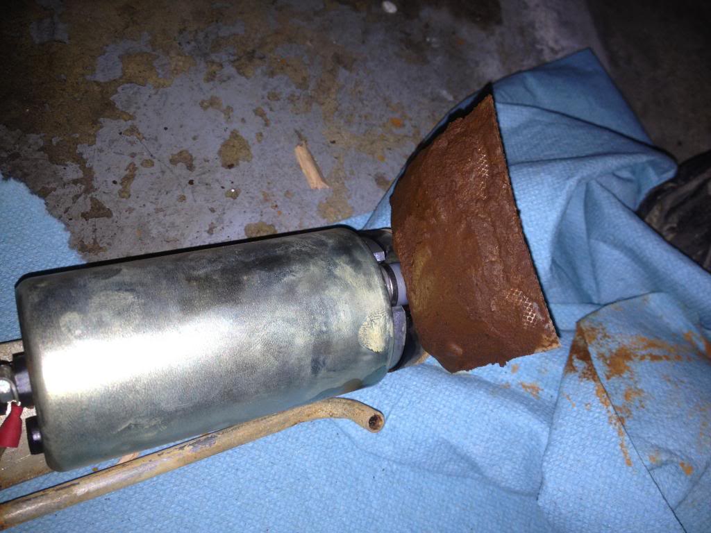

I realized the truck had a fuel pump that was not correct for the truck. The one in the tank was way to small and the fuel pump screen was completely full of rust/gunk from the tank.
I put in a brand new pump (correct one) and pump strainer.
It ran great for about a day. It then started doing the exact same thing the next day. Issue not resolved.
Put on another brand new fuel filter, still no change. although the inlet side had reddish gas that came out of it. I drove it for 60-70 miles to try and diagnose it or find out another clue. I came to the realization that the tank had sat for a period of 3-5 years before I had it and was probably full of rust.
I pulled the new pump again to look at it. BINGO i thought, the strainer that was only days old was full of rust and gunk again. Most of the thick rusty gunk is in the bottom of the fuel pump "basket" in the tank. I cleaned out the gunk and tried to make sure the tube wasn't clogged (but I cant confirm it is or isn't) I poured some gas in with the plug pulled and got a good majority of the big stuff out, I got a new fuel pump strainer and put in some fresh gas. I thought this would solve the problem based on how bad it looked. Drove it for 3 miles and the problem is back. I know I need to get a new gas tank, but thought a fresh pump, strainer and filter with new gas would at least temporarily resolve the issue if it was the tank.
Im at a loss here. I think my next step is too start chasing wiring problems, and that sucks! I considered injectors, but it seems that if it were them, it would misfire consistently right? not just cut in and out? Any advice would be great. I am off friday and will be working on the truck then. I would prefer to not take it to a shop.

If that gunk has been passing through your fuel system, my first thought is that you might have clogged injectors or fuel line blockages as a result. At full-throttle (WOT) with clogged injectors, your air/fuel balance could be skewed enough to make the truck sputter and buck like you are describing. At only partial throttle, they might be still spraying enough fuel to keep the cylinder running, albeit poorly.
Finish cleaning/replacing the tank. As long as you have that going through your engine there's going to be issues, both immediate and long-term. When done, run several injector cleaners and/or Seafoam through your gas tank.
You might even try running Seafoam through your brake booster line straight into the engine. If the rust/grime that passed through is recent, the Seafoam might be strong enough to remove the buildup in your engine.

Don't forget to flush the line between the tank and filter. From the front to the back, while you have the tank dropped. Air will be fine, if you can rig something up with a parts washer or fuel pump even better.
Also inspect the supply line for kinks or other damage.
That looks alot more like dirt and algae to me. Notice how clean it is where it was wiped off and in the sump. You could probably just wash it out and be good to go. Might need abit more refurbishing if there is surface rust. Red-kote, or another tank liner of your choice. Don't forget to get out the inspection mirror and check the top of the tank.
If you can stand it being down for a couple days clean and reseal on the tank will save you some cash. Which you could spend on new hardlines and an injector clean and tune..

Ordered a new gas tank from Rock auto for $80. I called a few shops and was quoted $140-200 to clean and seal my existing tank. It is not worth the time to me to clean mine myself for $80 ya know. It would take days to complete and hours of time.
I also ordered a new clutch master, fuel pump strainer and fuel filter. As soon as the parts get here, I'll start back on it.

All of my parts arrived. The gas tank looks awesome. It's quite a bit nicer then my oem one lol. I also have a new fuel filter and fuel pump stainer. All purchased from Rock Auto. Great website.
I also got new front bumper ends. They were only $3 each! How does everyone now own a new set of these. I also have a new clutch master to install. I will be on it Sunday after my Easter stuff is done.
I cleaned the fuel pump Strainer and blew compressed air through the fuel line and then drove it the other day. Drove perfectly for about 8 miles. Then it slowly started coming on worse. I drove it about 40 miles total. I pulled the pump again to see what it looked like. The fuel pump strainer was already getting clogged with rust! I have a good feeling the new fuel system components will do me a lot of good!
