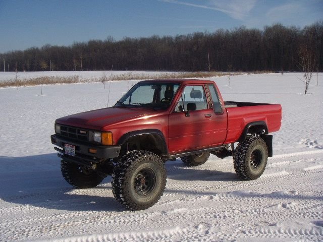

I started looking for a decent Toyota pickup in 2009. After driving all over NE Ohio and looking at a bunch of rusted out frames, cabs and beds, I took a break from the search but still browsed craigslist/ebay from time to time.
In Dec 2010, I was browsing ebay and found this 1985 2-3 miles from my house! I looked at the truck and the frame was the best looking old toyota frame I have ever seen in Ohio, so I bought it! It was a little more built than I wanted/needed, but for the price, I couldn't pass it up. The guy took excellent care of it and hardly used it after building it.
22R, 5 speed
166000 mi.
35" Dick Cepek Mud Country tires
5.29 gears
1988 rear axle (wider) w/ARB air locker
Front axle has a Aussie locker
Sky offroad widening kit with '86 IFS hubs (wider front track)
land cruiser vented rotors and v6 4runner calipers
Front Range offroad twinstick
Procomp 4" suspension lift
2" 4crawler body lift on the cab
home made lift on the bed
frame coated with with POR15
Pic from the day I bought it:
I cleaned it up and took some more pics:

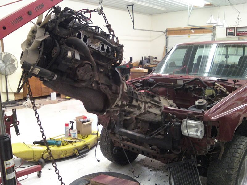

So next I bought this 1986 with a bad frame but a good motor.
I took what I needed off the truck, sold the cab, interior & anything else decent.
(33x10.5 allterains were a second set of wheels for my truck, since it was also my daily driver)
I also cut & welded new inner rear frame rails on my truck.
Got the 22r in my truck and headed back to wellsville in the fall of 2011 for round 2!
