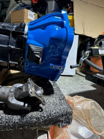

Got it all cleaned up, painted and ready to go back in.

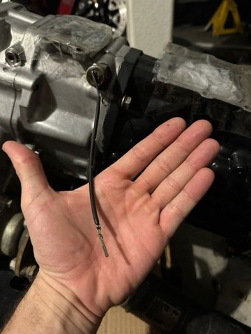

I noticed my 4wd indicator switch was screwed up..

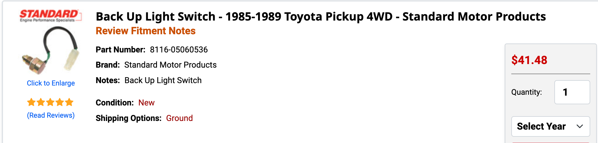

is this the correct replacement? https://www.partsgeek.com/wtykvdq-to...IaAuzgEALw_wcB
Looks like it might be..Just want to make sure.

That link doesn't work.
You can't load that terminal back into the connector?

I stuffed it back in the connector. I might need to get in there and do some soldering.
So that replacement won't work? Im trying to find other options in case I have to swap it.
Your link just goes to Partsgeek home page, not to the item you're thinking about buying. Click it and see
Terminals have tabs on them to lock them in place when you slide them into a connector. It'll slide in, but the tab keeps it from coming back out unless depressed. No soldering needed.
If the tab on the terminal got ruined maybe you ll need to crimp a new one on.
here's a picture of a spade terminal with the tab. If the tab is still there, just flattened, maybe you can fix well enough that it locks in. it doesn't take much.

Looks good. I still think the old one is an easy repair, though

Appears to me that the switch on the tranny is one wire while the replacement shown is two wire.

Ok, wait.

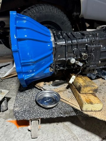

The back up switch is two wires, but in your picture with the assembled transmission you have that installed and it looks ok.
So you're looking for the 4wd indicator switch. No, that one from PartsGeek will not work. Not for that. The oem number for the 4wd indicator is 84222-35020 and it's discontinued.
Good catch Millball.
