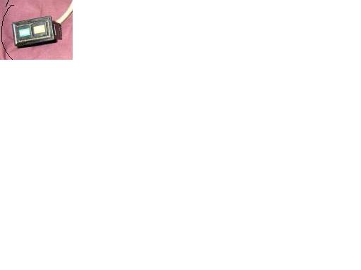

so my intermitten wipers weren't working and living in seattle that is kinda of a nicety (ya, i just made up a world).
i got this switch off ebay for an 86, i have an 85, i'm thinking it will work. if not, i'm not out that much but,,,,,, my 4runner does not have the two button (red/green, i think it says "pwr" and "on" or or "norm" or something on the green) so i'm wondering what that switch is for and if my harness has a plug in for it, should i plug it in?

Sounds like the ECT (Electronically Controlled Transmission) button for an automatic.

my 4runner did allready come with the intermitten wipers but they are broken, i only have slow and fast. so i hope it will be plug and play. just added the pic. had sizing and upload issues then had to go to a meeting, sorry bout that.

it is a ect switch to hold the rpms up on a automatic tranny between shifts

thanks got it................guess i will not be plugging that in since mine is a 5spd.
