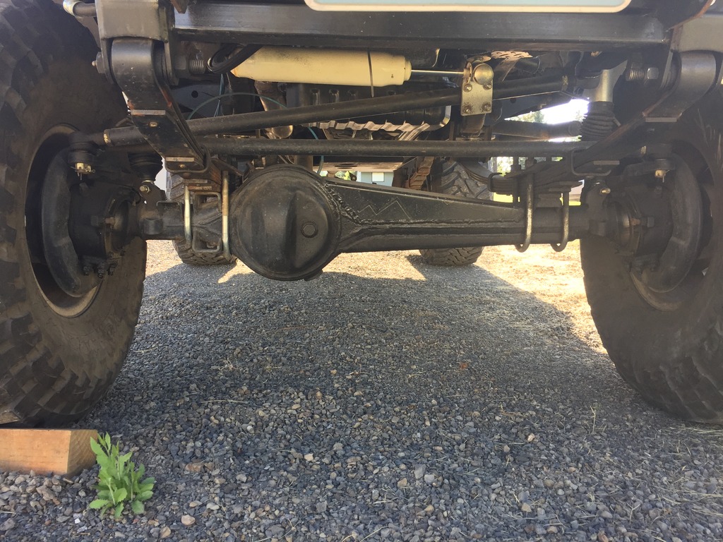

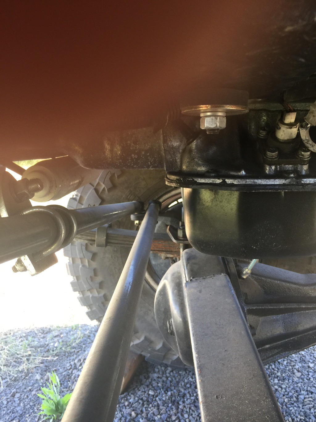

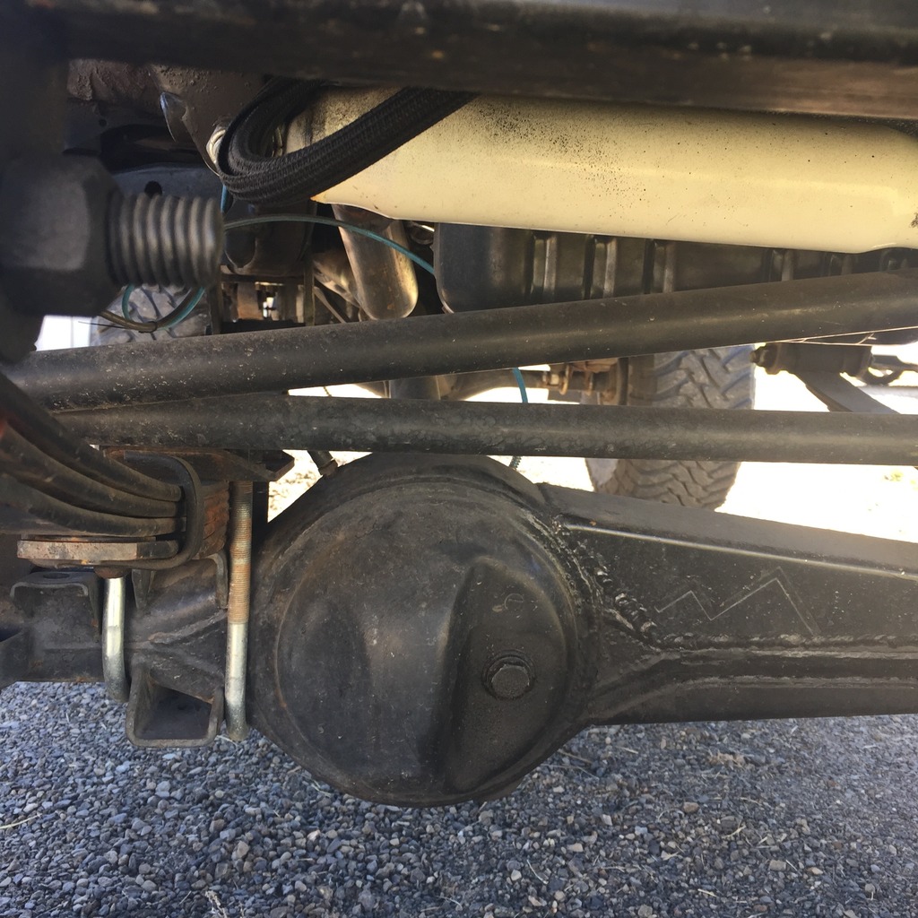

I've been researching the RUF setup. It seems the 84-88/9 rear springs would be the way to go since they have the shortest distance between the front hanger and the center. I mention this because I'd like to lower the front (and rear), but I'm a little limited on how much I an lower the front because of the 1UZ oil pan that is right above the axle. If I could move the axle forward 3-4" more then I think I could gain quite a bit of clearance. Take a look and let me know what you think!
I have the TG front 4" on the truck now. If memory serves me correctly that moves the axle forward 1.5". The center to front hanger distance on those springs is 22", so couldn't I gain an additional 2" forward by using the 84-88 rears up front? That couple with drilling a couple new holes in the spring perch (gain another 1" maybe") and then the RUF springs are 48" long where the TG ones are 47, so I could move the front hangers up another inch. I think that would be about 4". I've already moved the steering box about as far forward as you can without adding more frame.
What do you think an acceptable distance is between the oil pan and the axle (vertical distance) if I can not get the axle in front of the oil pan. The engine is placed as far back as possible. I'm looking to run 33-35s (I have 37s now).

the first thing i would check is how the two crossbars on the steering line up at full stuff.
if you want to go forward 4", you'll need 4" of horizontal clearance there, to keep those bars from hitting each other.
with spring articulation the axle moves slightly backwards, so it needs to be checked at full stuff.
to you have a side picture of the steering box location? if there isn't 4" of clearance, you'll have to move the box forward or get a short steering arm, but the latter would defeat the goal of making it a better daily driver.

I just took a look at the box. It is definitely something that would need to be addressed because I have it sitting at an angle right now.
I'm running 47" front springs (TG) with 5" shackles. Would I be able to get away with running the 48" RUFs and utilizing longer shackles or should I move the front hanger forward 1"? By looking at the oil pan and axle relation in person, I don't think there's anyway to get around the oil pan. The axle would have to be moved too far forward. I can only drop the truck so much based on the oil pan to axle distance. Wish I could just link the front, but it'd be a major PIA and the main vendors that do links said it was a no go with that engine in there because of the clearance along the frame rails.
