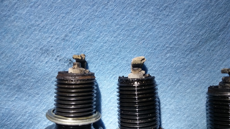

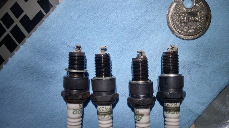

Old Plugs:
Attachment 115825
Attachment 115826
I wonder if the problem is getting worse lately because the plugs are getting caked again.

I wager if you put a new set of plugs in it fires right up atleast the first time. I also would suggest you don't run those acdelco plugs regardless of the cost and what the "shirt" at the counter says, pay whatever the difference is and get the spark plug specified in the FSM (from memory this is a bpy5s), there are plenty of recounting of the 22R/RE not likeing other sparkplugs. This won't solve the issue but it will run closer to the engineering spec and fire up much smoother for a while.

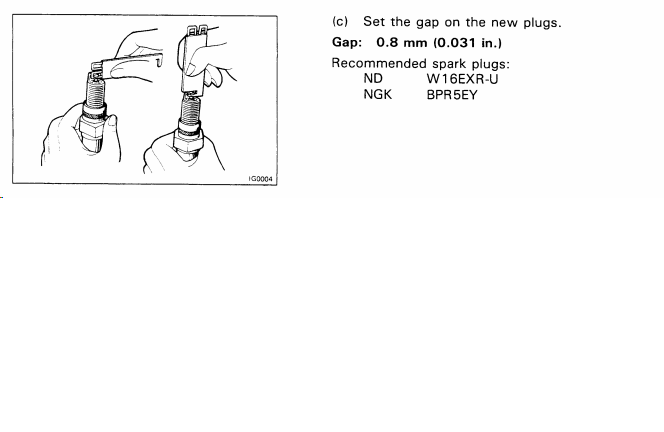

1) new spark plugs (NGK website says I need BPR5ES - I think I have BPR8ES in there now. Looks like they're just a couple of steps hotter.)

I’m running an ATF treatment on it today. I was going to run a compression test cold then hot but left my tester at the hangar and won’t have time to go get it this weekend.
I got my vehicles mixed up - the BPR8ES went into another car. The 4Runner had another set of auto lites in it. The plugs looked a lot like the ones in the pictures above, and the threads were wet. New NGK BPR5EY plugs and an oil change tomorrow as well.
