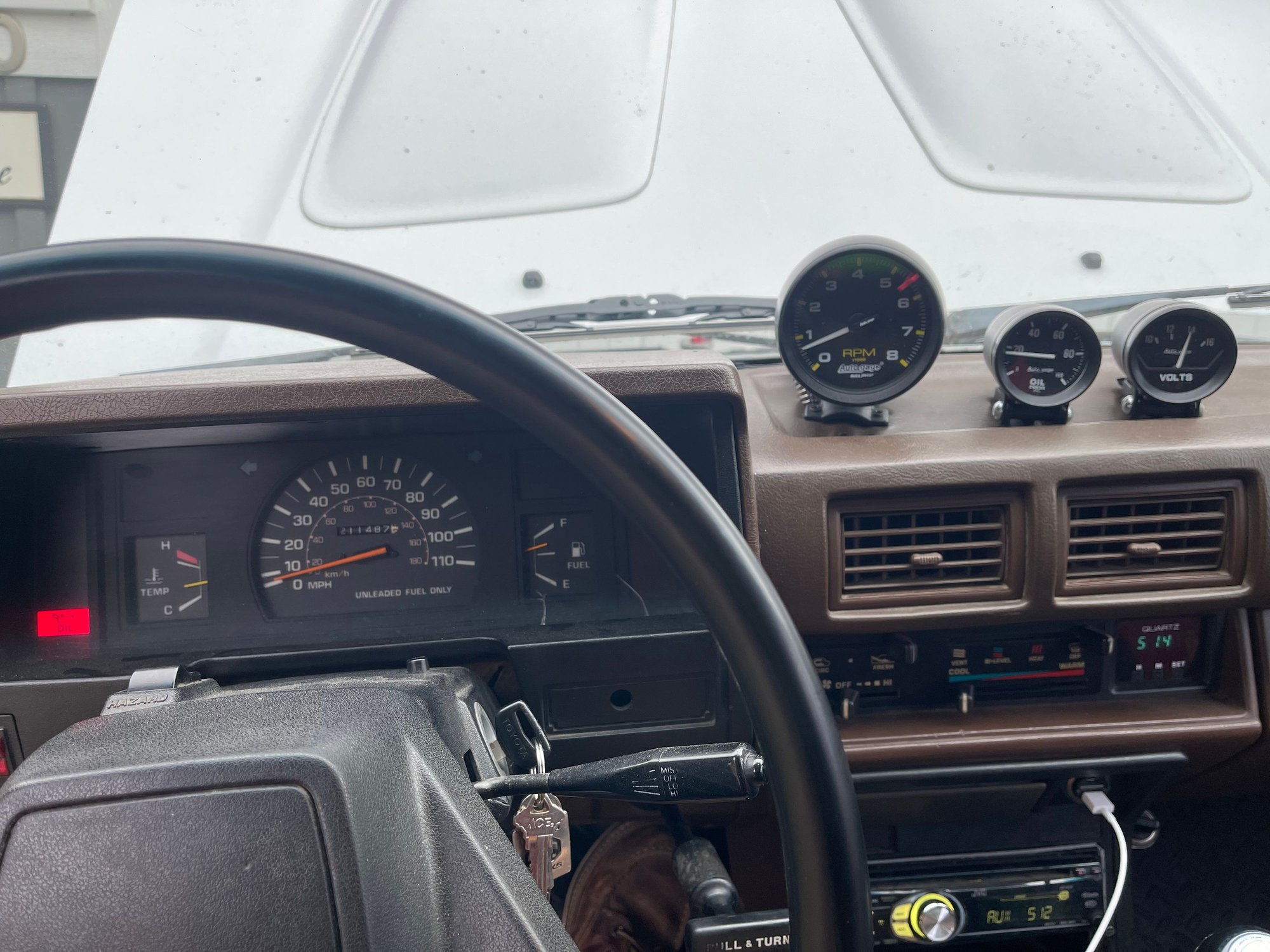

My 85 22R runs like a champ but, I just developed a problem with the oil light. My idle is set around 550RPM. Prior to today, engine cool and at idle, Id get oil pressure around 15-20psi. Warm it would get a decent bit less. Warm and idling, my oil light would come on at times or flicker. Any time it revved at all, the light would go off. Today, my RPMs/pressure dropped and my oil light came on but, when it revved up, oil pressure built but the light didnt go off. Let it cool down for a time, started it and the light was off until it warmed a bit and came to an idle, when the light came on and didnt go back off. I know my pressure is good but, the oil light irritates me. Where do I start to look for the problem? Replace the oil sender?
Heres my oil sender setup with a stock sender and line to my mechanical oil pressure gauge.
Heres oil pressure and light at idle.
And heres the oil pressure and and light when slightly revved.
Let me know if you have any advice.

Well, since you have verification of the oil pressure by the steam gauge, you know, that when the light goes on, the pressure is good. Tells you the OEM system is in error. Now, the trick is to figure out just what part has failed.
Looking at your set-up, I would first ensure the wire is good. No dirt, oil, etc where the connector attaches to the sensor, and that the wire itself iss good. Try wiggling the wire around when the light is on. Flex the wire a little bit. Pull the wire off the sensor, and check the pin it goes on, make sure it's good and clean.
If it's all good, my be would be the sensor. Oh, yeah, check to make sure no dirt bits have gotten into the sensor, preventing it from reading the oil pressure. After all that, try replacing the sensor. All things being equal, the sensor itself would be my guess right off.
