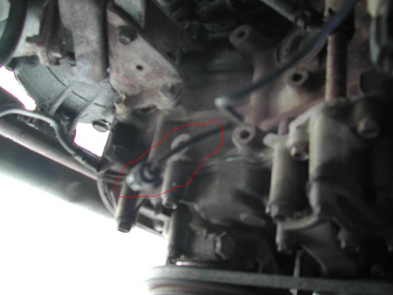

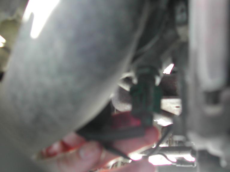

I did however find this wire that comes off of a harness that seems to have the connectors for the oil pressure sensor on it (???) and it is unplugged. However I can't find anywhere to plug it in.

Can you get a better picture of that? It doesn't look like your oil sensor plug. The oil sender is located directly behind the pass side mount, under the oil filter. Should be round with a rubber cap over it with a wire sticking out of it.
Check to make sure that is tight.
Once you check pressure with the mechanical gauge, you might look into whether the sensor is faulty.
sorry, all I could get were blurry pics. I'll try again tomorrow since I couldn't find anything to hook it up to
if I hook up the gauge and the truck has oil pressure but then it drops real low when it warms up I will take the pump apart and check that valve I mentioned before, unless that is dumb

from what i can tell from the pic, that hanging connector looks a lot like the one for the temp sensor; would explain your temperature gauge not working. as for the oil pressure, i would replace that $4 sender before i did anything. funny readings like that are often due to faulty sensors. not being scary, but an oil pressure drop when warm is indicative of worn out bearings = excessive oil clearance.
yeah if you could let me know where to get the sensor for $4 I'll replace that ASAP
I guess now I need to figure out where the temp sensor is so I can figure out if it is plugged in.
