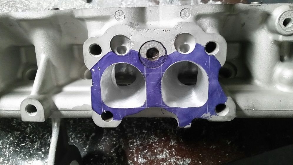

Anyway, I have a question about the head on the exhaust side. You have those 4 tubes on top of the exhaust ports, I'm not sure what they are called but I believe they have something to do with emissions, the ones you end up blocking off. Looking inside the head in those 4 tubes, 3 of them are broken and 1 is I guess long the way they used to be (see pics)
Can i and how do I remove them? It seems to me that these tubes would hinder the flow of the exhaust

I would just drill them out. They should be removed or plugged if blocking anyways. Also I'm surprised it didn't come back cleaner like this.

Drill the top flares off and pull them through, Or mini air saw, cut the end inside of the exhaust port and pull them out.
They are for the air injection. I do not know why they go so far in, when they are supposed to be helping the cat.
Ahh, I could almost smell that blue dykem............... brings back the past when we used layout line to tell us where to make the cut. Back in the 60s , was the only way till NC took over then CNC.........lost art

Ok, All drilled out, what a pia, these tubes are hard. Had to use 4 different sizes drills to sneak up on it., finally got to where I could pull them out. I also went ahead and taped them for 1/8 pipe so I could put plugs in them
