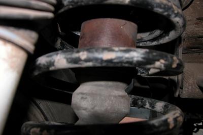

The "temporary" (forever) solution was EXTEND Bump Stops to limit wheel travel in the rear Axle. This weekend I will take some photos to show the actual damage of the tank and the new Bump Stop extended.
?Someone else with a rear 4" inch Lift can send pictures of the space between the bumpstop and axle base?
(I think the BumStops are too large now...)

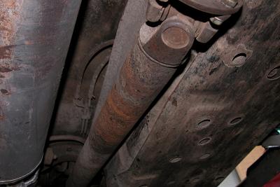

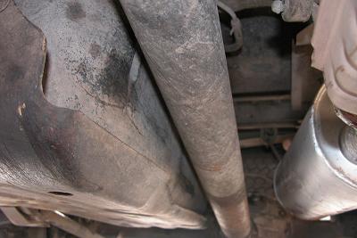

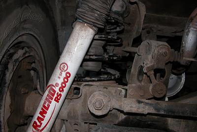

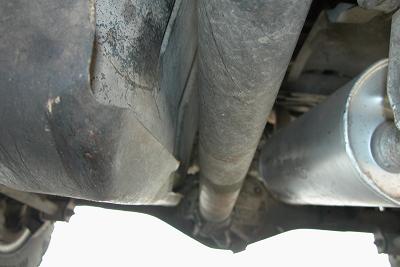

Old Apr 3, 2007 | 07:04 AM
pcardenas's Avatar
Joined: Mar 2006
Posts: 16
Photos...
Attached Thumbnails Fuel Tank wasted by Drive Shaft?-dscn0004.jpg   Fuel Tank wasted by Drive Shaft?-dscn0005.jpg   Fuel Tank wasted by Drive Shaft?-dscn0103.jpg

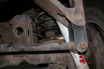

Old Apr 3, 2007 | 07:05 AM
pcardenas's Avatar
Joined: Mar 2006
Posts: 16
More photos...
Attached Thumbnails Fuel Tank wasted by Drive Shaft?-dscn0105.jpg   Fuel Tank wasted by Drive Shaft?-dscn0109.jpg   Fuel Tank wasted by Drive Shaft?-dscn0110.jpg
Old Apr 3, 2007 | 07:39 AM
LUV24BY's Avatar
Joined: Jan 2007
Posts: 442
From: Phoenix, AZ
Nada problem about the mis-listed post. Us 1st Gen guys could have that possibly too! I did look at all for your pictures, and excuse me for saying but I don't see much damage aside from some rub marks. Do the pictures not do justice to the actual damage? Also, there seems to be a slight bit of movement on the gas tank skid plate edge. I was thinking from your original posting that it had literally almost opened up a huge hole in the tank.

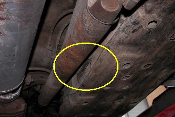

Old Apr 3, 2007 | 01:18 PM
pcardenas's Avatar
Joined: Mar 2006
Posts: 16
Hi,
the damage is marked on yellow. There is no hole, but was close to it. The problem is that a hole means FLAMES and total lost... (search on 2nd gen forum to see it...)
This is very dangerous, and my idea was to avoid the posible future severe damage.
Is fuel on that tank... only a liltle spark and.... There is no way to shutdown these kind of fire with a simple "fire device" (extintor)
Best regards,
Attached Thumbnails Fuel Tank wasted by Drive Shaft?-dano1.jpg   Fuel Tank wasted by Drive Shaft?-camio1.jpg
