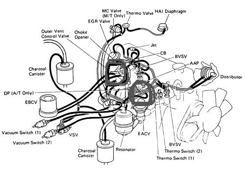

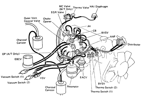

So I got it! It was some vacuum lines hooked up wrong! Check out the link or the attached pic.
vacuum diagrams

I circled them in light grey. Paint wouldn't let me add color. Anyway here you go.............

they were switched or not plugged in? just those 3 hoses right? ahhhhhhh i'll probably check my whole system but thanks dude. i hope it helps
Old May 3, 2006 | 02:08 PM
  #73
Total Distortion's Avatar
Joined: Apr 2006
Posts: 4
They were switched around a bit. Just triple check everything.
