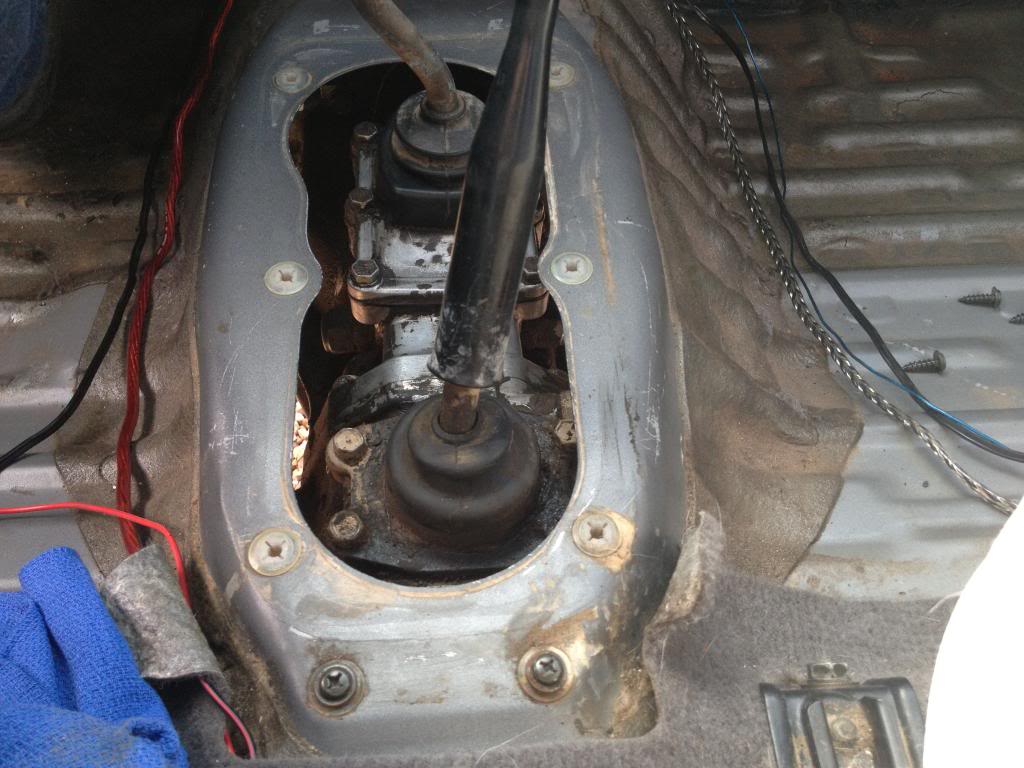

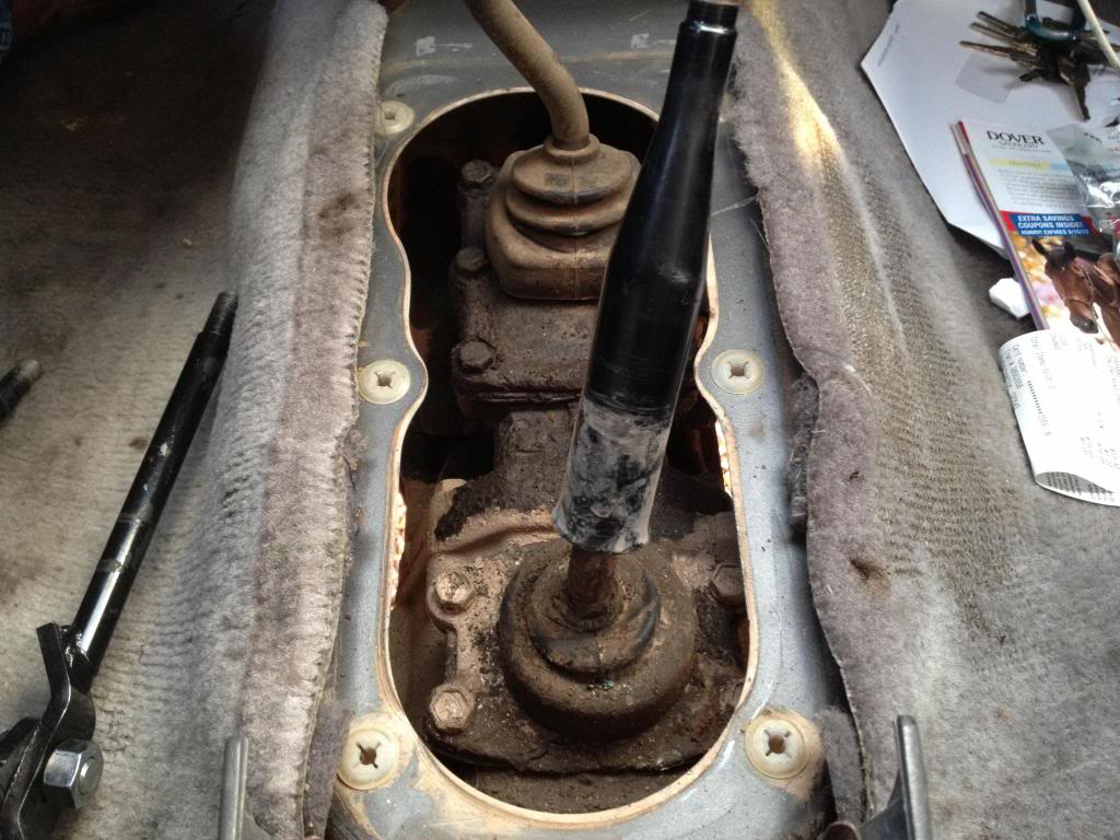

So I pulled my shifter boot on my 1985 toyota pickup SR5 to start the process for dual cases with tipple sticks.
My whole set up seems to be more to the passenger side(see pics) is this normal? I know my transfer-case and motor mounts should be replaced. My body mounts look good and straight. Anyone else have this issue?

Your mounts are throwing it off, same thing happened to mine. mine werent even attached LOL

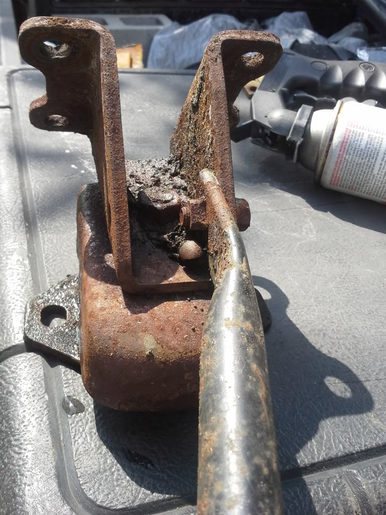

You should be able to use a rh mount on the left hand side unless you have the bar attached to your right hand mount in which case a lh mount will have to have a hole drilled in itName:  20130726_163016_zps23d7c74e.jpg

The left and right mounts are the same. You can reuse the bracket shown in the photo above. I removed my mounts without taking the brackets off of the block.
Of course, that may have been because they had completely separated and pretty much fell apart once I got them unbolted.
Btw what dose that braket hook up too? None of our other motor mount/trucks have it

That bracket bolts to the engine block on the passenger side. It's not technically a part of the engine mount (as in, if you buy a replacement engine mount, you don't get that bracket with it). You can see it above the bell-like-shield of the engine mount here, with the oil filter peaking out from behind.

I just looked at your Toyota Parts Zone link. Are talking about the $80-something part? I think that might be the metal bracket and not the rubber mount. You might want to call them before ordering and check. That's way too expensive for just the mount.
It would also explain why they list one for the right and one for the left. The brackets on each side are different.
