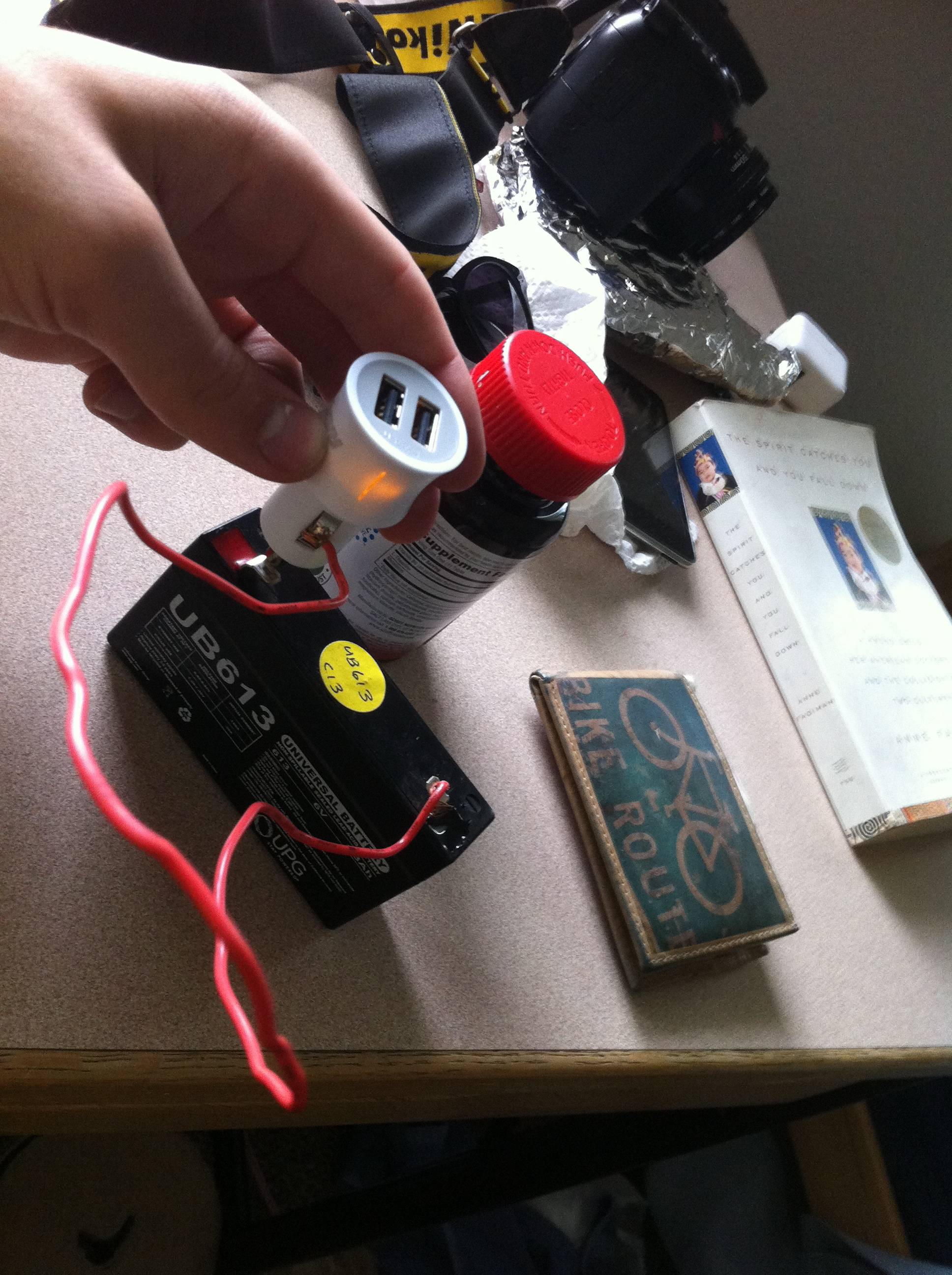

Just to show the simplicity of a USB circuit, this is a phone charging system that I'm wiring up for my bike. The battery was like 12 bucks, and the 2 port charger was 6 bucks at Walmart. It's designed for a 12 volt car system, but I'm charging my phone just fine off of a 6 volt battery.
The red wire is the ground. I couldn't find any black wire.

That's bitchin! I'm definitely going to do that, it's a lot less expensive than a new stereo, although I due for one in this little truck soon!

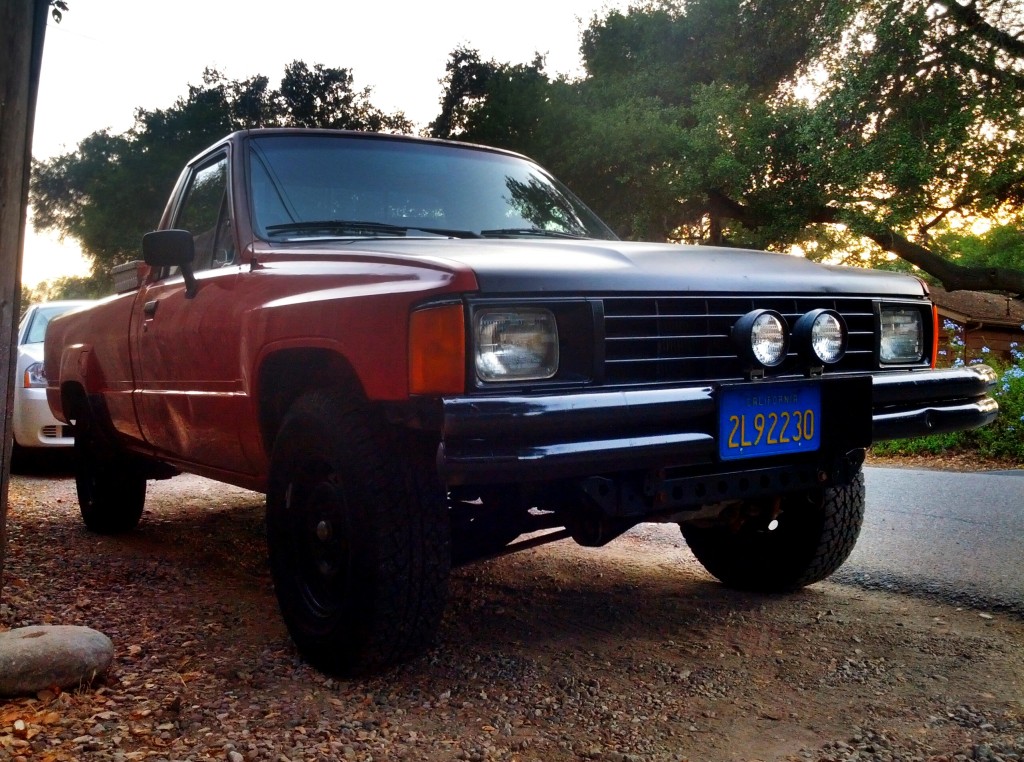

Thanks for the advice guys! I'll try cleaning the contacts one last time, otherwise I'll just wire in a USB port. Here's a pic of my 85 sr5 long bed that I've brought back from the dead:
