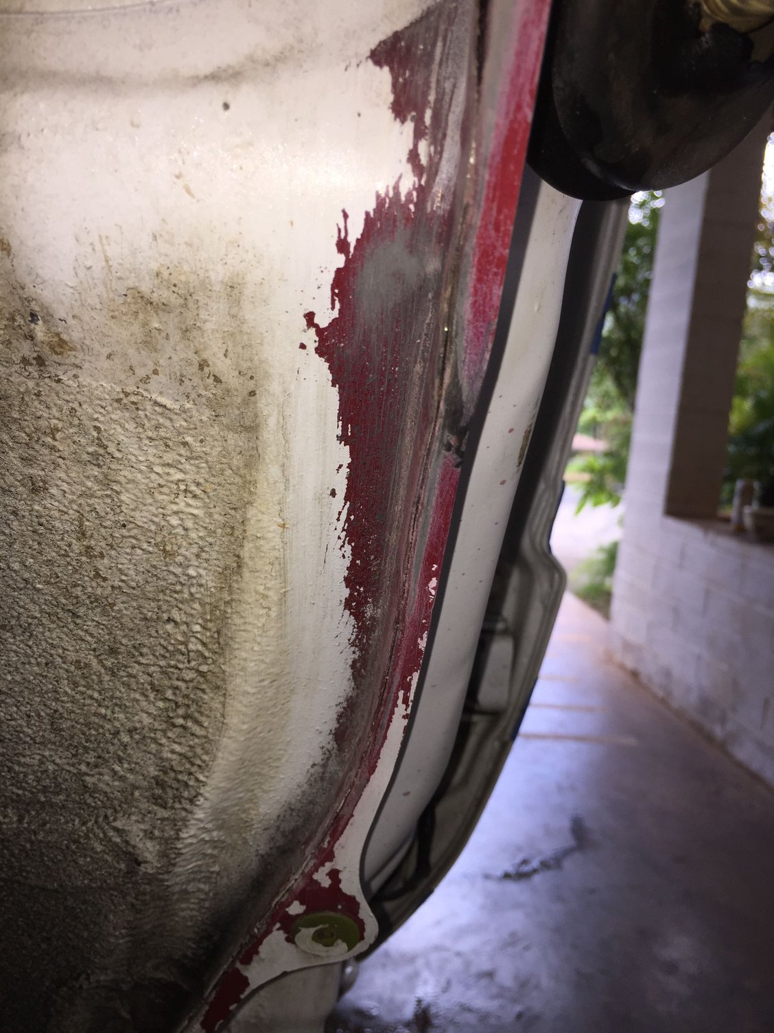

Leaking cowl
Hello, I realize that the op solved the problem but I just wanted chime in because I had a similar leak. It turned out that the leak was coming from inside the cowl where the fender meets the firewall, much like Blue_85 said. I found it by removing the cowl, cleaning it and running a hose down there. I was able to clearly see where it was coming in as well as a little corrosion.
To fix it took the fender off, scraped the old seam sealer out and removed all the rust I could get to. I then prepped, POR-15'ed and applied new seam sealer. I also drilled a small hole in the cowl where water pools in hopes that it'll drain better. I ran a hose in the cowl for 10 minutes and no leaks. Now I gotta repeat it on the passenger side.
Here are some pic of the outside of the repair. I couldn't really get any good shots of the inside but I did the same thing on the inside under the kick panel.
I apologize if this is a thread-jack but thought I'd add to what Blue and others have posted, the windshields do leak but the cowl can also give you problems.
Pics (I hope it'll work, this is my first post).
Seam sealer removed, clean metal
This was where the leak was, a tiny gap.
I added this hole to hopefully help it drain better.
A close up of the location of the hole, I tried to get it in the lowest spot (and don't worry I touched up the paint).
