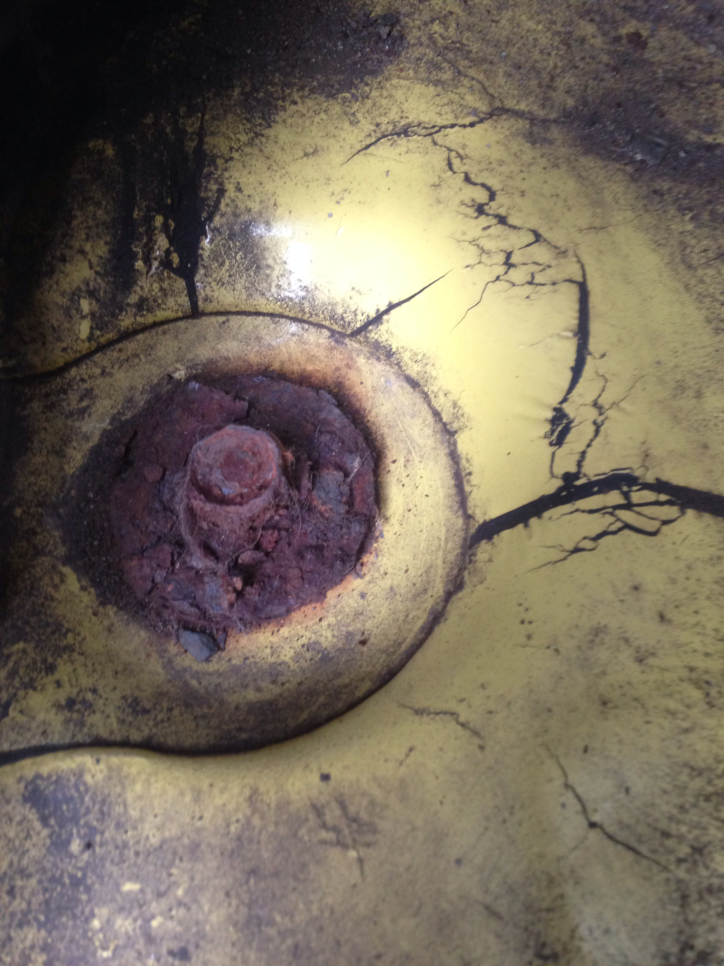

Looks like a good truck to start with - much better than what I started with! The truth will lie in the cab floors. Go ahead and pull back some of that vinyl flooring and see what is under there - particularly in the front corners around the body mounts. If you don't have rust there and there is no rust in the seems of the bed then I would say you have a considerably "rust free" truck! You could also get some damn good money for that bed too - rust free short boxes are pretty impossible to come by these days. I got mine from Corey (Slacker), but I was willing to pay an obscene premium for a good original up until I bought my fiberglass bed.
As far as your oil leak issues go, get GOOD SEALS. Don't waste your money on cheap seals and gaskets or you will be regretting it the second time your replace them. I only buy engine seals from Toyota or Engnbldr and I use Marlin Crawler EcoSeals for my axles and t-case output shaft seals.

Thanks for the advice! I've already ordered the front seal and I can't remember the brand but if it isn't one of those when it gets here I'll just order another. Haven't ordered the rear seal yet so I'll definitely get one from those guys.
I'm 99 percent positive there isn't rust where you mentioned but now that you mentioned it and I'm thinking of it I'm kind of doubting my memory haha.

So I looked around and I think I may get an engine rebuild kit from LCE and a few goodies from ENGBLDR once I get to kansas and get my garage set up with an engine mount and hoist.
In the meantime I thought I'd take a picture of the body mounts where you said to look for rust just to make you a little jealous.

Of course, I'm going to get a new set of bolts for these mounts haha.

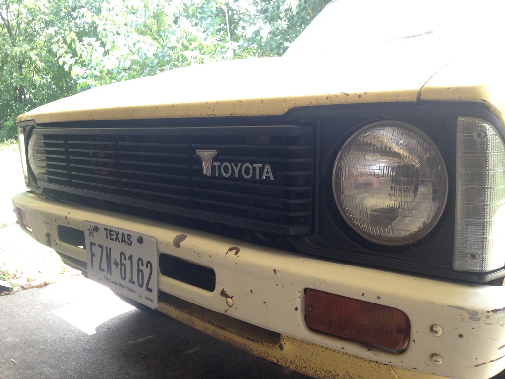

Plasti-dipped the front grill and headlight doors so they're at least one consistent color instead of undulating tones of grey. Also put in a new horn since go figure the 34 year old horn didn't work anymore. It's kind of too bright out to see it but I think it looks nice. I had wired up a second one (I got a set for free from a friend) but with it wired up neither horn would work so I figure there isn't enough juice for that or something. I don't know, I'm no wizard when it comes to electrical. Which sucks because I kind of want to go through the harness and clean house/replace old wires so that my electrical system lasts at least another 34 years.
