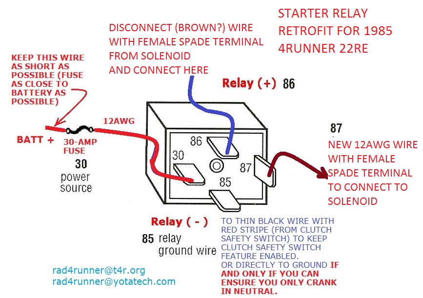

No need to buy Hot Shot Painless wiring IF you're comfortable with electrical work. Just wire in a general purpose 30-amp automotive relay to work as starter relay. Wire like below.
Just need:
  • 1 30-amp or greater relay,
  • A fee of feet of 12-AWG wire
  • 1/4-inch female spade terminal
  • and wiring supplies.
Once you get cranking system working well, work on cleaning up the wiring. Restore it to stock so other members who are thousands of miles from you could easily help.
