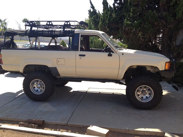

no worries, you know i thought about that and i took it to a shop that does leaf springs and he suggested i replace the leafs because i only have 3 in the pack that are on the truck now. each leaf is thick not like the all pro...more leafs but thinner.. and i had 3inch lift blocks in the back..so i was due for a set of springs....i started taking it apart and man i will need a extra set of hand..i will keep you guys posted. im already seeing an issue with the angle of the axle..but i will see for sure when i bolt it all up...plus i will need longer u bolts..im in san diego anyone know who might have these in stock locally?
bolted everything up and it is a bit higher than i wanted. however, i like the way it looks though ! and rides way better. i think im going to leave it like this. i will be doing the rear here in the near future. i will need to extend my front drive shaft, and the shocks and mounts..but so far i like !! i am wondering if these springs will settle at all...
