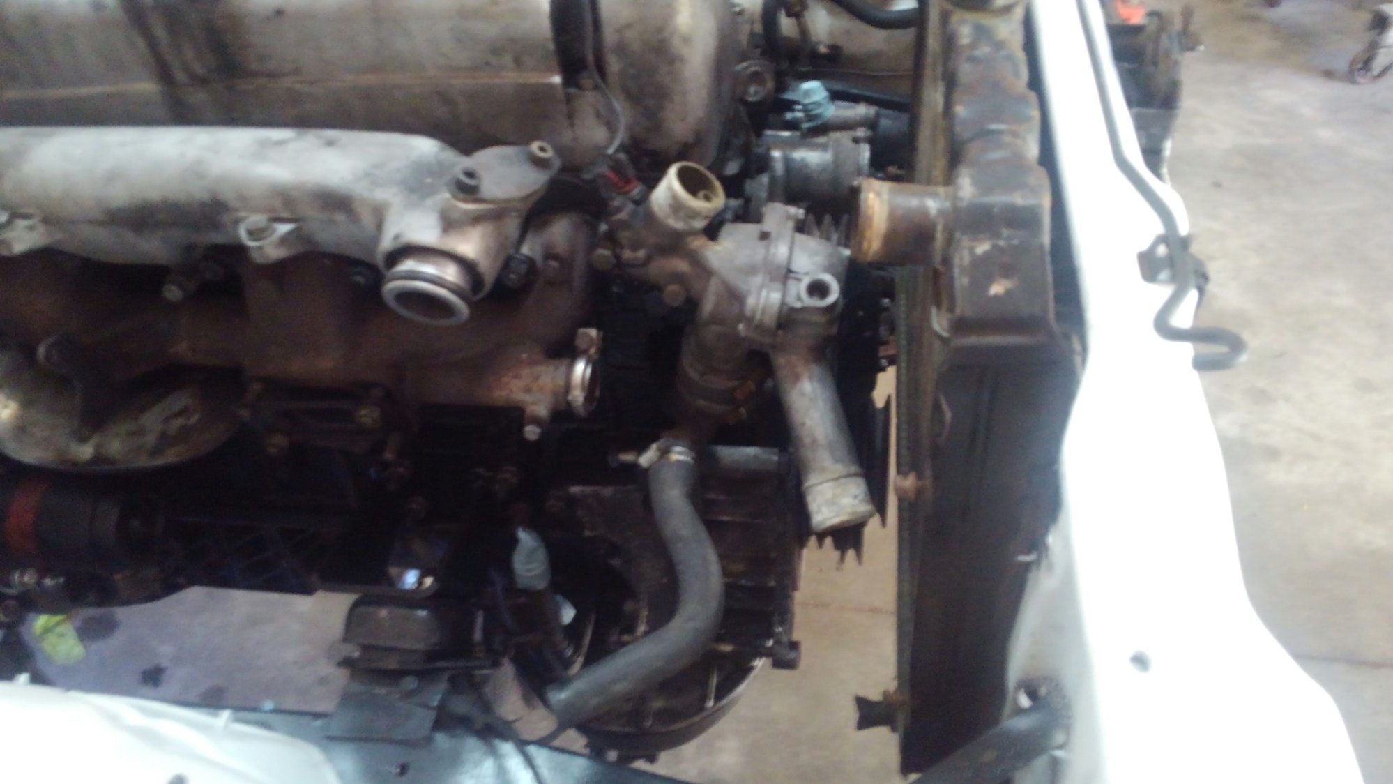

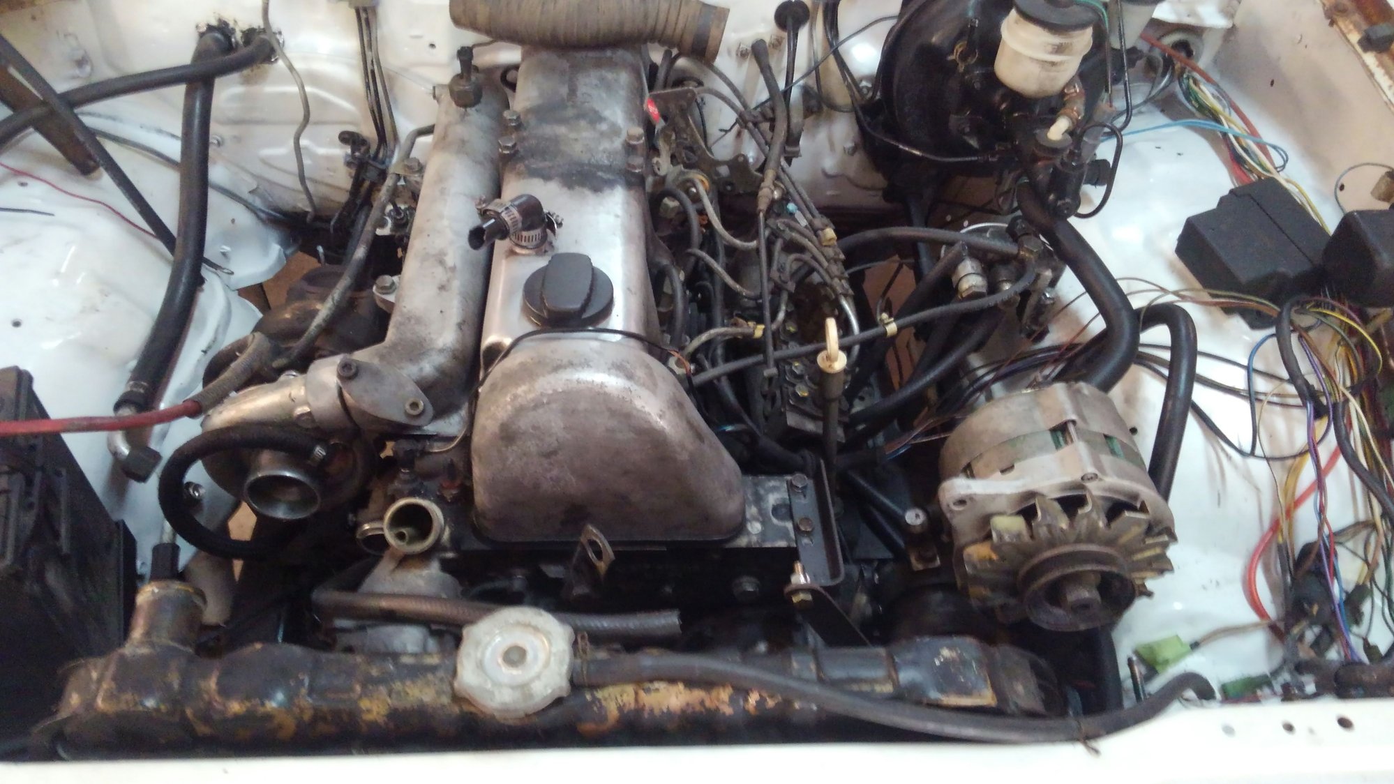

Who has photos of their MB diesel swapped engine bays? I'm wondering how some of you have setup your first gen pickups, particularly the oil cooler setups and glow plug timers. I'm currently in the process of mounting the relay box and wiring in my Doomsday Toyota wiring adapter. I also need to ditch my coolant overflow tank, but not sure what to do about the wash fluid tank also.

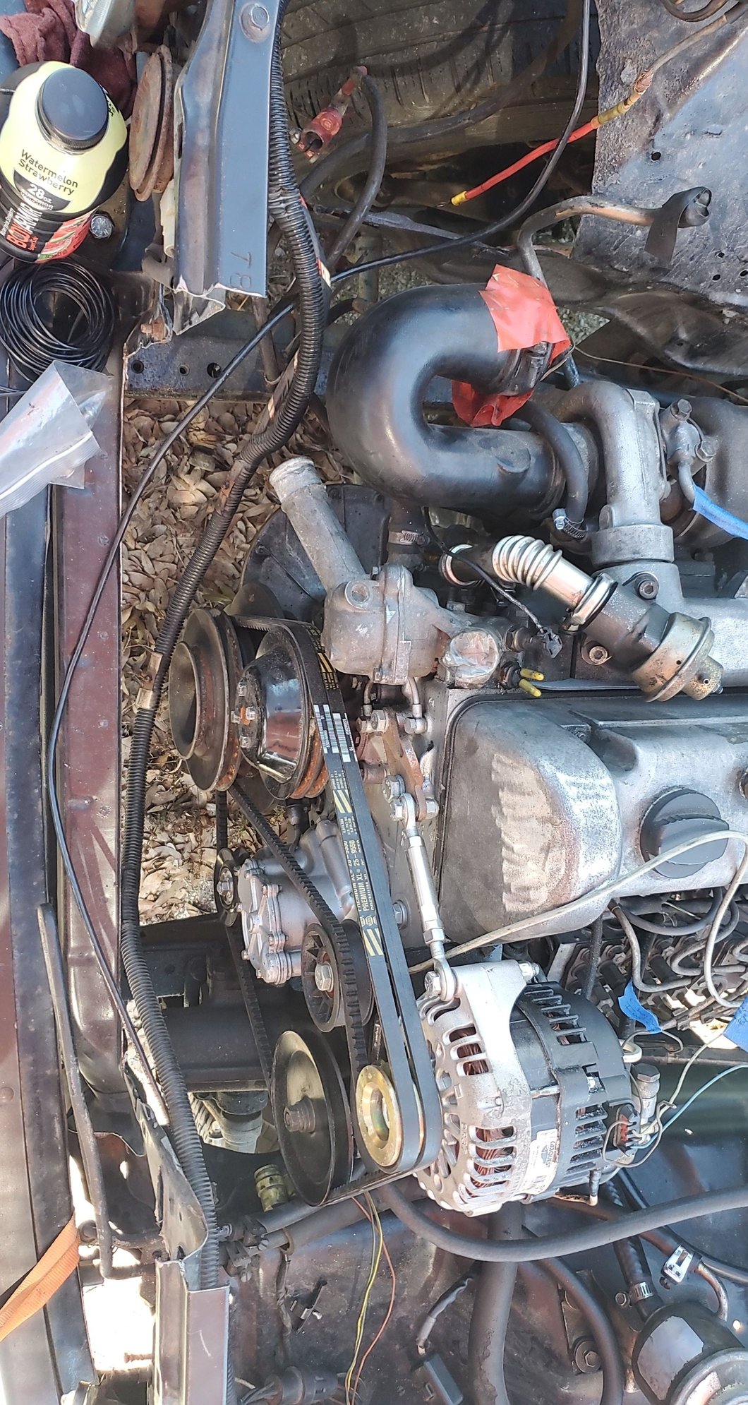

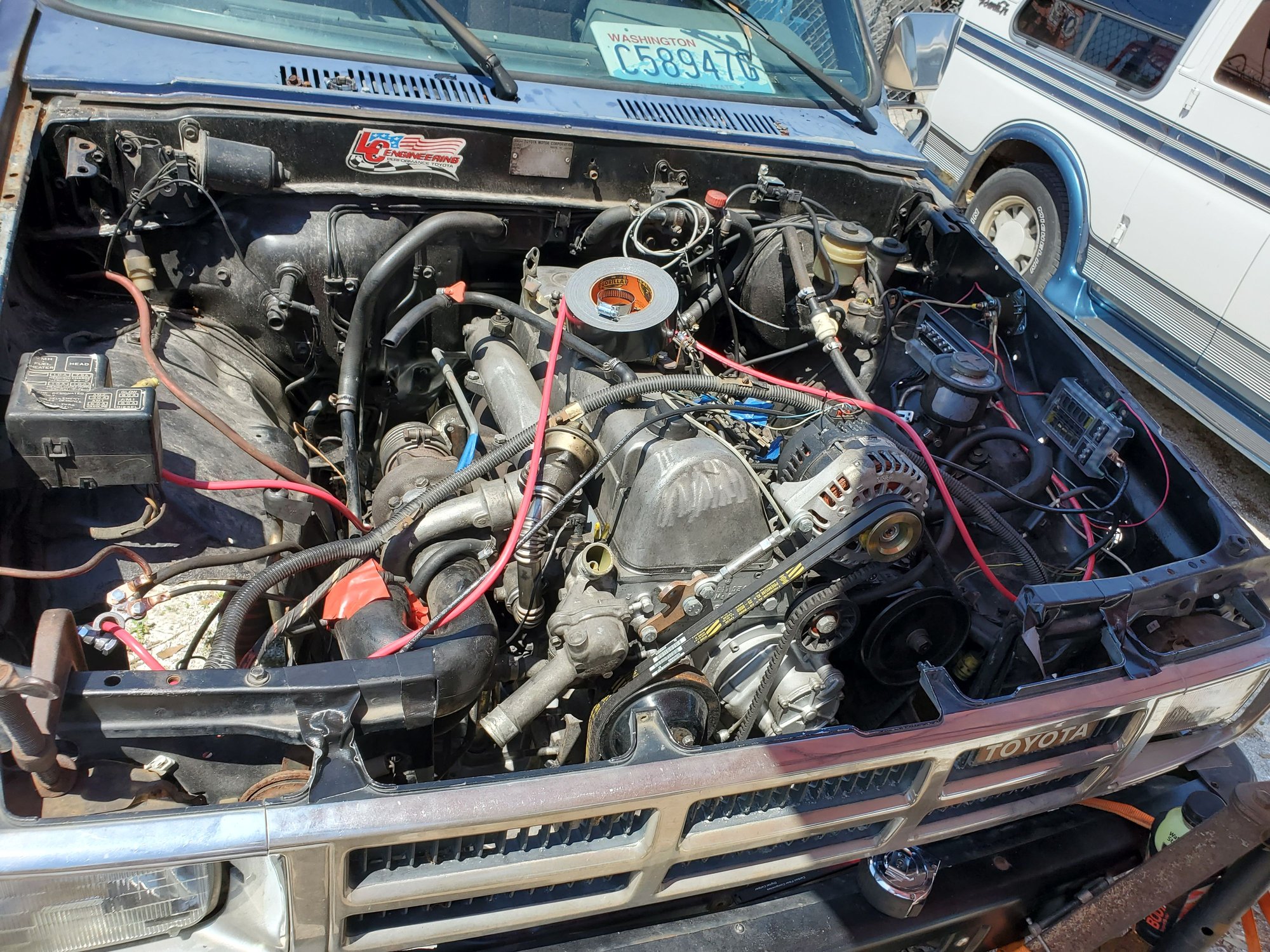

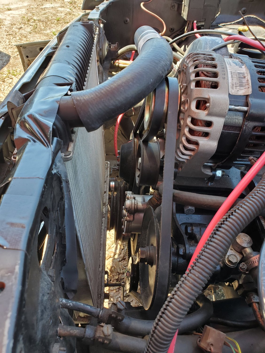

Heres a couple as I'm closing up my swap.

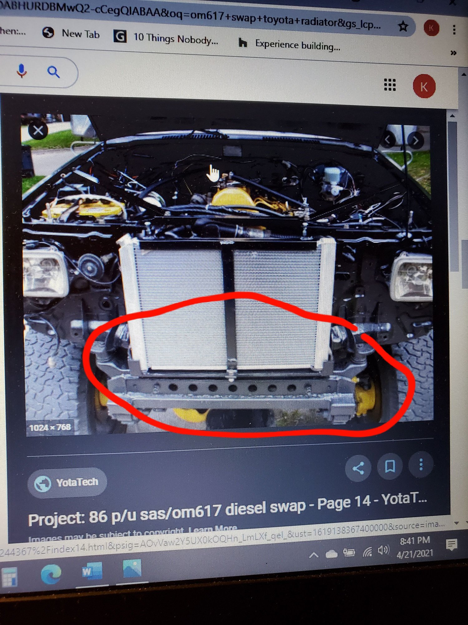

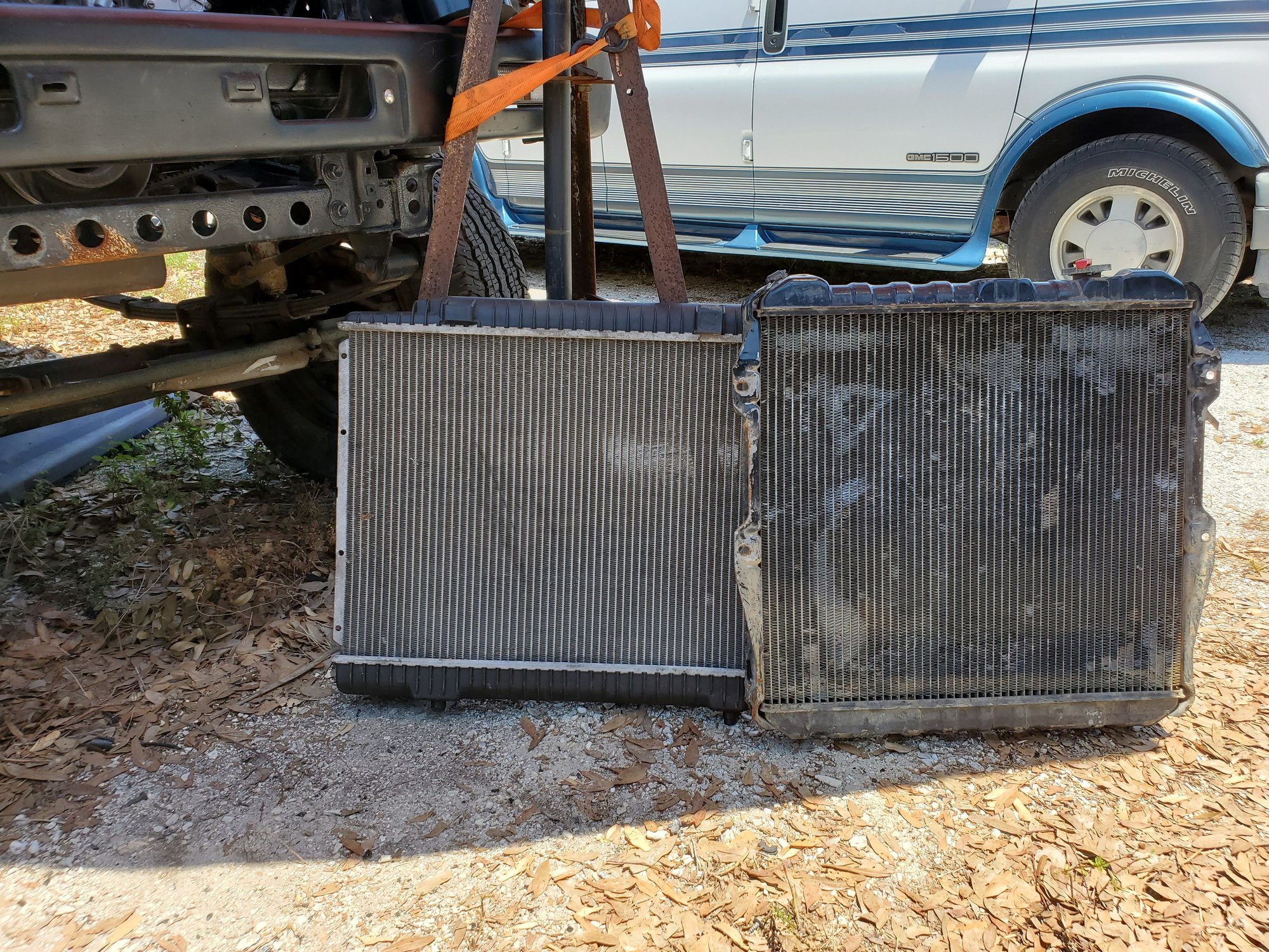

Old Apr 22, 2021 | 07:36 PM
SwampCabbage941's Avatar
Joined: Apr 2021
Posts: 1
Originally Posted by warmonger88
I don't think I'm going to use the Mercedes radiator, its a little tall, even with a 1" body lift. I'm needing to build a new crossmember for the transmission now before I do a final positioning of the engine since pulley to radiator support clearance is a concern still. I have the little expansion tank too, but space is pretty limited in my engine bay. I've installed the doomsday adapter for the oil filter housing already, I have the double filter head and t-stat also. I'm planning on cutting the fittings off of the Mercedes oil cooler and tapping them out to m18x1.5 to use a pair of adapters to -10AN so I can mount them on the radiator support under the grill. I saw this done on a first gen 4Runner on here if I remember right. The doomsday wiring kit was a breeze to use and it really took the guess work out of setting up the glow plug timer, wait to start light, and shut off solenoid, worth the cost and looks really clean.

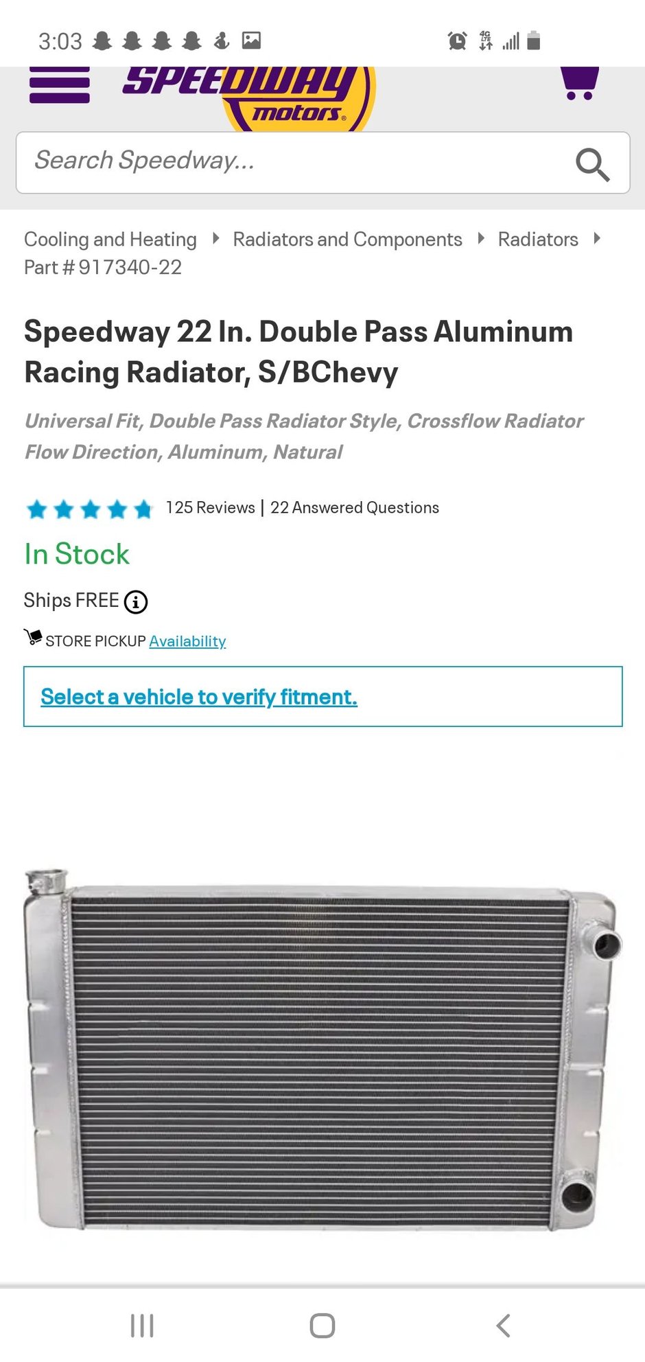

I tried the MB and the 22r radiator and they're both too tall,, even with a 3inch body lift.. I went with a 19" tall x 22"wide x2.75" thick dual row chevy small block radiator from speedway motors, both the outlet and inlet are on passenger side of the radiator. It should work perfect and allow room for a 16" fan hopefully.. ill let yall know.. Im also cutting out the bottom core support and rewelding and reinforce with flat bar and angle iron, after I come up with a clamp/ bolting configuration for easy radiator removal.
