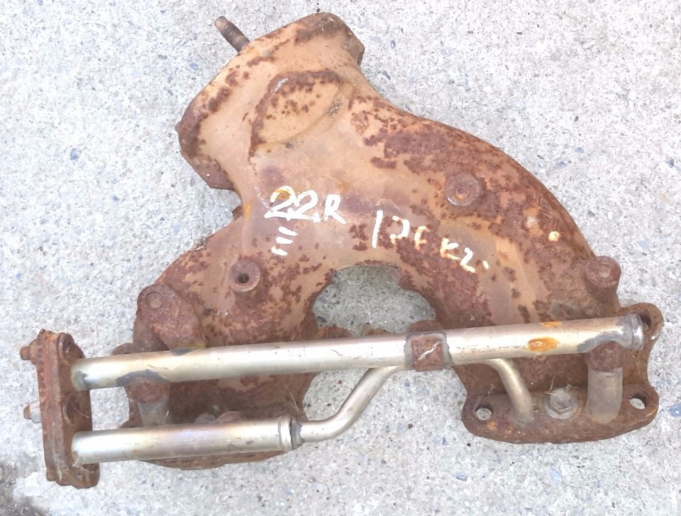

The main difference between the 20E manifold and the 22R/22RE are the inlets for the fresh air injection system and the outlet port on the bottom of the manifold where it connects to the rest of the exhaust system.
On the 20R, the fresh air injection ports are facing upwards, towards the hood. On the 22R/22RE they are facing outwards, towards the drivers side fender, and are located just above the main exhaust ports. I don't have a good pic of the 20R but the 22R looks like this:
Shown with the air injection tubes installed.
The bottom outlet port on the 20R manifolds are a single port, while the 22R/22RE is a double port like this:
So that means if you go with a 22R/22RE manifold you're going to need a new headpipe with the double port flange to match up to it; more $ & work.
You can't use the 22R/22RE manifold on the 20R if it's used and genuine Toyota because the head flange is NOT drilled for it as tscheuch mentioned. You could find a decent condition genuine Toyota unit & drill the hole out yourself, or have a machine shop do it for you.
