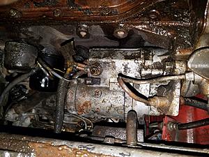

when I looked at it the cable looks like crap could that cause this?

I'm not sure, but bad connection could cause a problem, too. Maybe it's not really grinding but oscillating (quickly turning and stopping) because the motor is not getting enough power.

yeah I'm not sure. It was almost a grind but sort of a buzz or whatever sound. Can you see that cable it looks like it was pinched and is exposed.

yeah I'm not sure. It was almost a grind but sort of a buzz or whatever sound. Can you see that cable it looks like it was pinched and is exposed. And has tape coming off of it. I might see about buying bulk cable by the foot and replacing that whole cable.
usually auto part places only sell the 2 foot pieces I will have to measure it up.

That's not OEM. Looks like they could get or didn't have a big enough ring terminal so they split half the cable out and taped it up.
Parts store will have various lengths from 1-4', maybe longer.
Start with the cable, maybe fix the leaks they don't go well with electrical stuff.

All that water is road spray. I took that pic not long after I got home.
but yeah I want to replace it!

Looks like it, too. There should be a rubber boot over that.
Yeah, no choice but to remove and inspect the starter and connections then test it off the truck.
