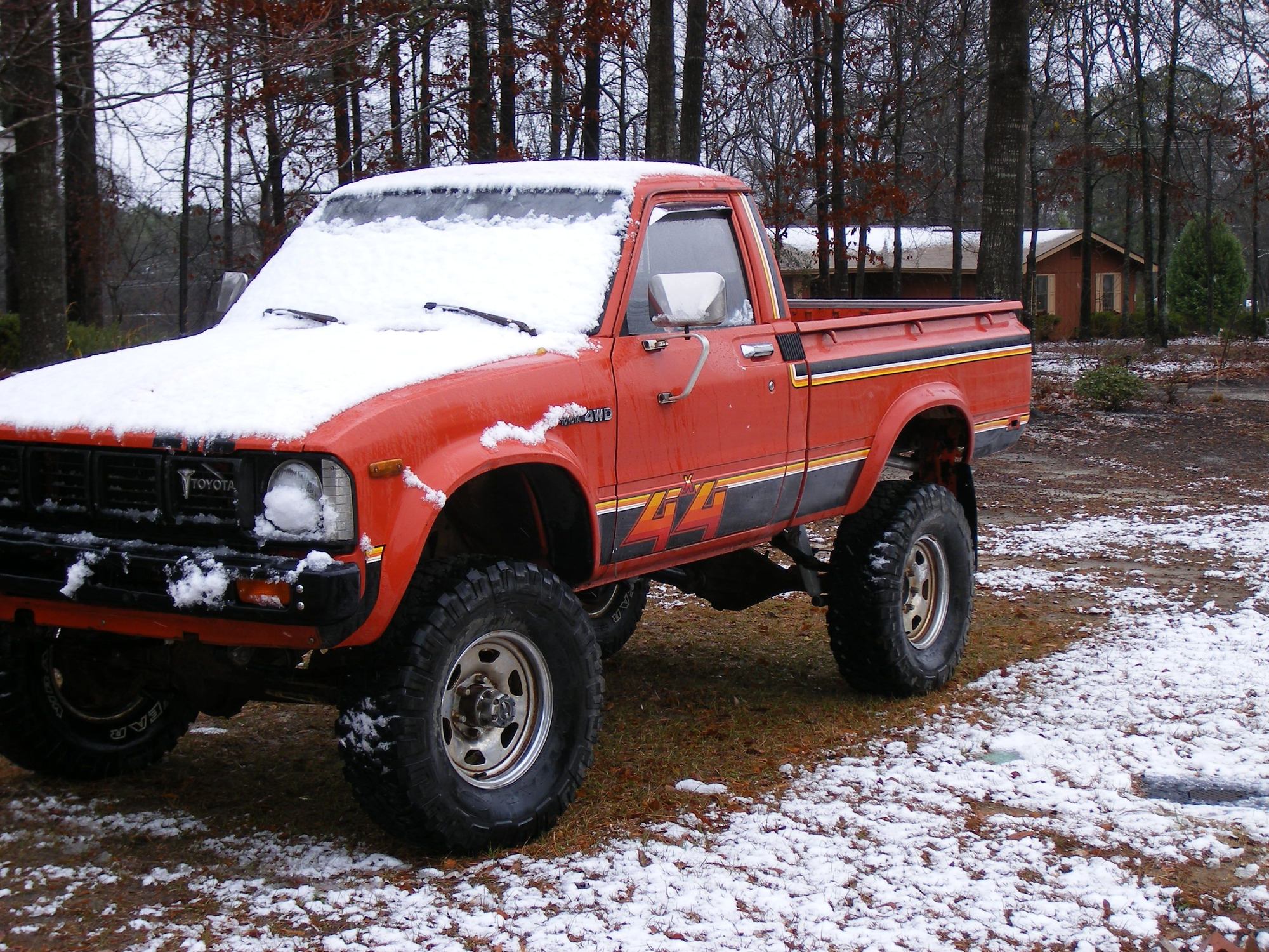

How about a pic of your truck? Why not stock springs from a wrecking yard and throw a bail of straw in the back? sounds like you want a 2015 caddy ride in a old ,,,....

1980 Original paint, 3 in Rough Country 32 Wrangler MT/R's.

Wow that's a beautiful truck, people say that the ome springs are the nicest riding lift spring (that's all relative) but if you look at kawazx6's build thread in the build up section you can see that you might need to relocate your rear shackle mounts. Why most lift springs are like that I have no idea..

Ooh, that's in nice shape.
You're in NOLA? They have snow there?
A stock first-gen is going to ride stiff pretty much regardless of what rear springs you have. There's just too high a ratio of unsprung to sprung weight. Longer springs seem to be softer, and people say the 63" Chevy springs ride great. My almost-stock longbed rides acceptably for my standards, which I'd say are medium-high (I come from BMW's).

Thanks for the posting of Pic, Looks Great!!! Why were you hidding it from us,lol. Lov the color and decal layout, super sharp. If its not dirt, watch that rust on rear wheel, it'll sneak up on your cool chrome wheels to make um gold,
