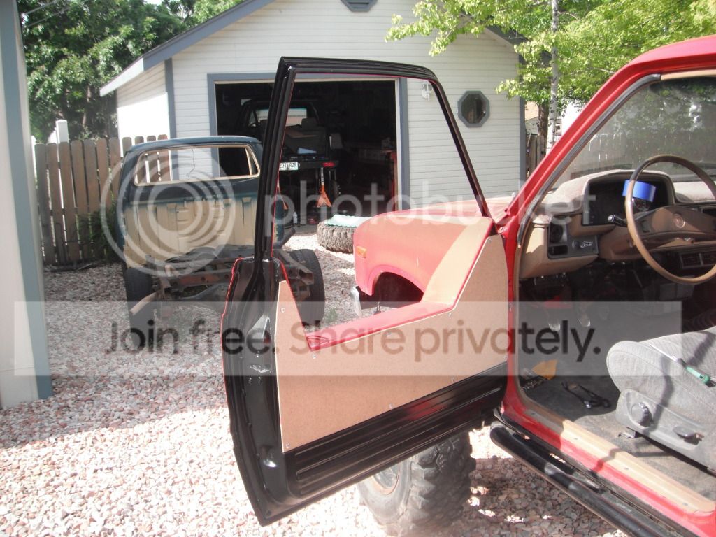

half Door Latch/Handle
half door latch-one approach:
I totally removed the door handle, welded the bar from the handle to a piece of 1/2" tube and brought it up through the window channel:
i wish I had seen this approach before I made my latch release...this is stupid simple.
I will post a pic of another latch so you can see how this one would work.

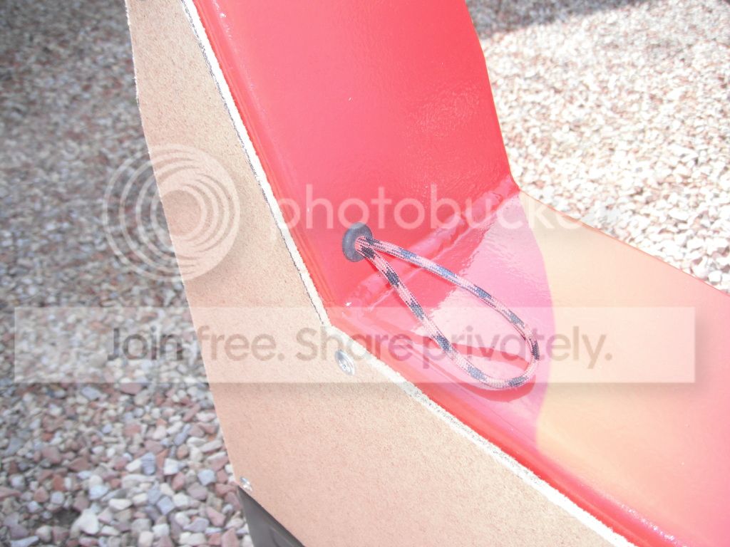

Originally Posted by OldGold3VZE
Wanted to share my really simple door release for half doors. It's just a piece of 550 cord tied in a loop to the spring-loaded lever that is normally attached to the inside door release. Passed it through the half door and used a grommet to clean it up. Best part is no rattles!
It does not get in the way at all and is very easy to use.

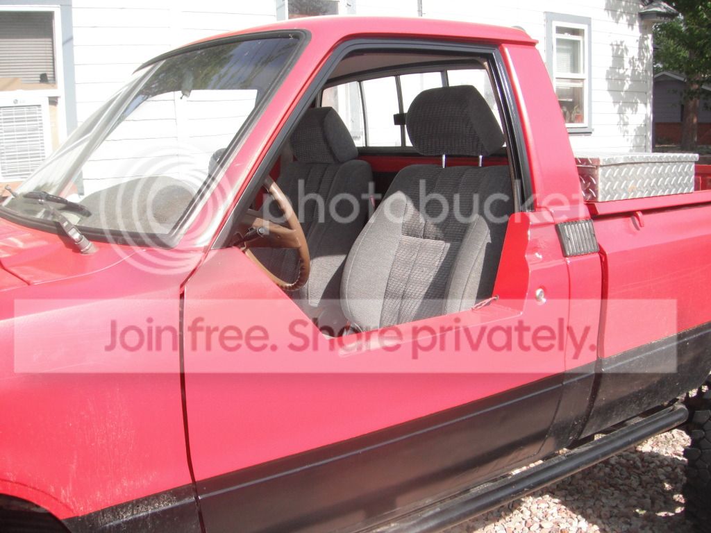

Passenger side.
Driver side.
