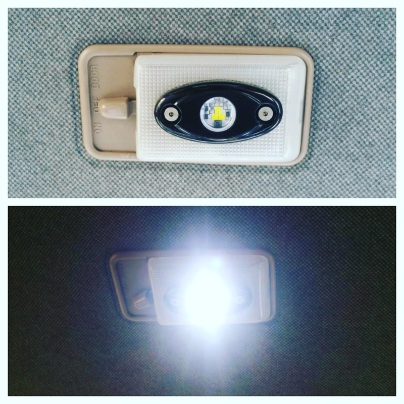

Dome Light Tweek
Old dome light switch gave up the ghost, tried soldering it but that lasted about a week. Dug into the parts stash and decided to make a small upgrade in brightNess
I may use the Duplicolor interior paint I have to make the housing color match but this will do for now.
