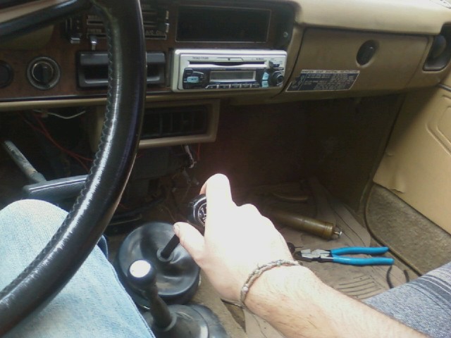

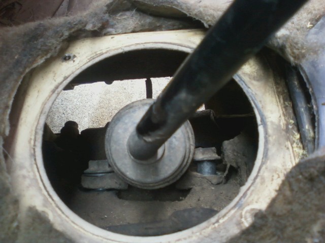

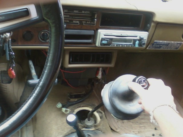

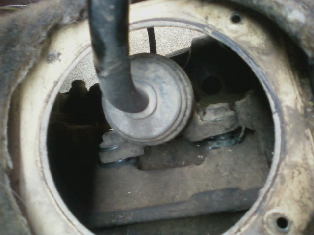

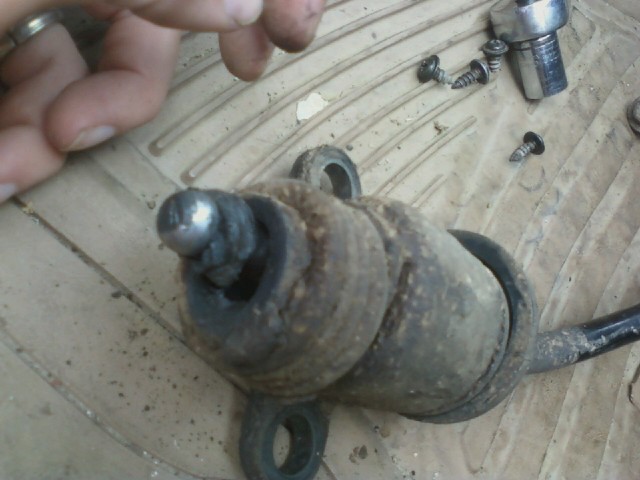

I'm bumping this thread instead of starting my own because I didn't take enough pictures for a complete write up on the bushing swap, so I'll threadjack this one since this was the most helpful thread I found. For the L43 you need (4) PN# 33615-20021 rubber bushings for the transmission mount of the shifter ball joint and (1) PN# 33548-20010 shift lever bushing. Its a super simple repair, you unscrew the four screws holding the shift boot plate, then undo the two bolts holding on the shift lever ball joint and the entire assembly just pulls through.
Those are the two bolts holding on the shift lever ball joint and assembly, you can see in these two pictures how much play I had.

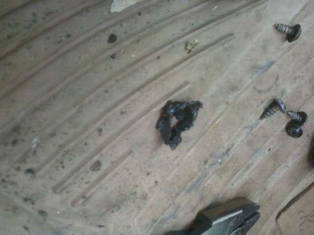

Once that's out, you clean it up and remove the remnants of the shift lever bushing from the end of the shift lever. This is all that was left of mine.

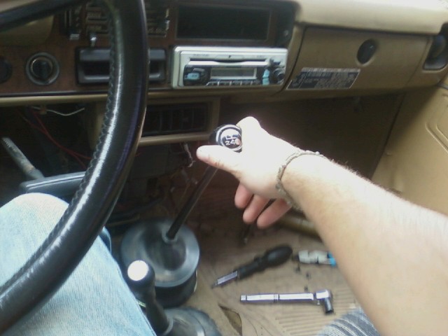

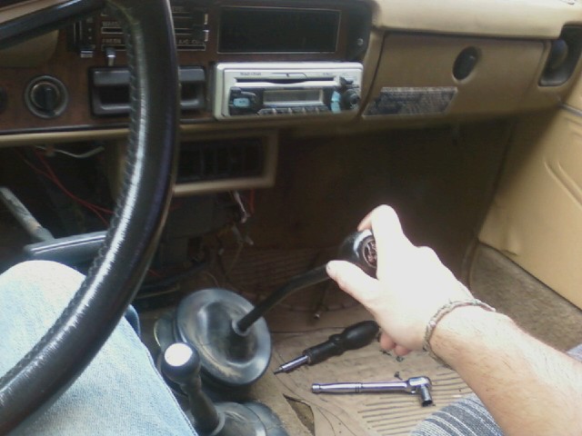

Then you clean everything and re-coat everything in grease and reverse install it. I was surprised at how simple the whole thing was, and it makes a HUGE difference; I can finally tell I'm upshifting from 3rd into 4th and not from 3rd into 2nd or reverse. You can see the amount of play I had in neutral before and after.

After:
And this is all the slop I have in 3rd (I forgot to take a before picture):
