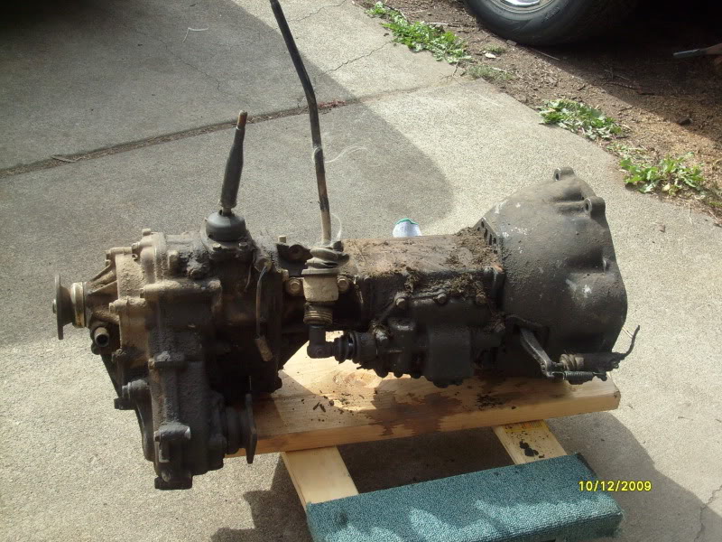

Originally Posted by cman1
ive never pulled one of these shifters out.do you just take the boot off,remove the two side mount bolts,and pull it straight out?
basically yes, but there should also be a retainer screw/bolt at the bottom of the shifter
you might be able to see it in this pic
Last edited by dropzone; May 16, 2012 at 10:19 PM. Reason: added pic, photobucket moving slow
