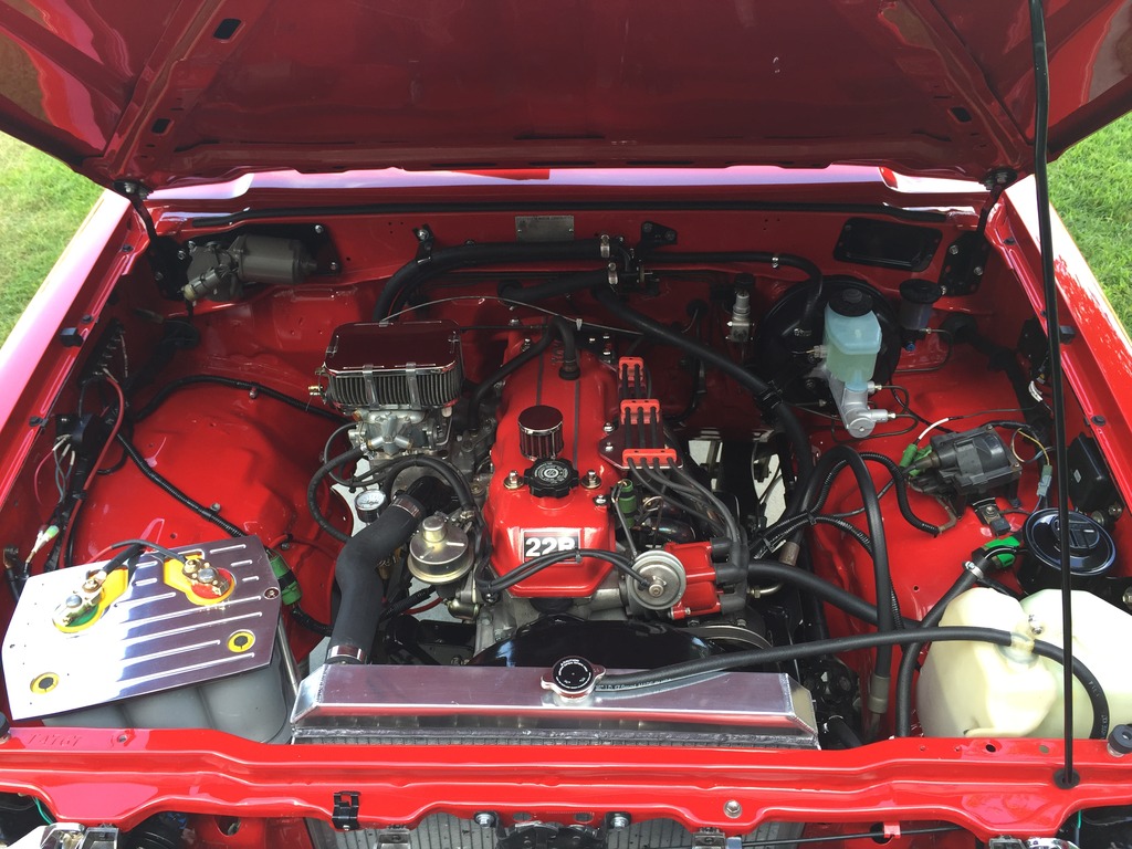

I wouldn't think twice about driving my 83 everyday like that other than the fact that I wouldn't want to pile the mileage on it being that it is restored and I have a 3,500 mile per year restriction on my insurance. My truck handles highway speeds well up to about 75mph; beyond that it can tend to get a little loose, but that is just the nature of the old push-pull steering. And my engine can certainly take the daily abuse. With all that said, you have to keep in mind that EVERYTHING on my truck has been either rebuilt or replaced so it is way more safe than your typical first gen pickup that you see on the roads these days. I tried daily driving my truck when I first bought it, but there was no way that I would leave the house without a set of tools with me in the event that I needed to perform a roadside repair. Since restoring it, I have confidently left my tools at home. I built my truck for looks and reliability (see pictures below), but your truck isn't going to be reliable until you can trust it and you won't trust your truck until it proves to you that it is reliable.
