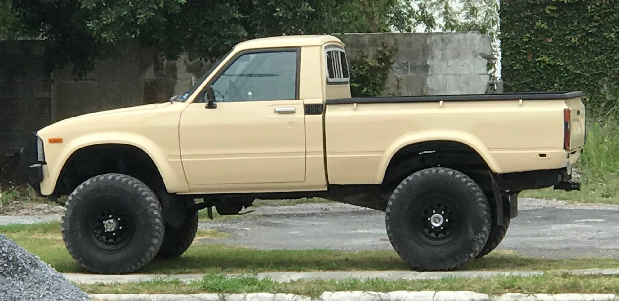

We’re not helping until we see the paint job!!!

if that's what it takes to get some help!
Here you go.
Bear in mind this is just when i got it back from the shop. It's missing the rear bumber, side lights and all the decals!

Very clean!
who needs an alternator with a good lucking truck like that?
If youre battery dies, some nice young lady will stop and help you out.
They probably unbolted a ground is my guess. Put a dc volt meter on the battery while running. It should read 13 or more if youre charging. 12 or less and that light means you have a problem.

Nice looking truck, I see they painted over the lock cylinder. Does this mean that it was painted at Freddy Fender's Forty Foot Body Works? (only looks good from 40 feet or more) Or was that intentional?

And yes the guy painted over my lock cycinder, I already took the paint off, I had t remove the cylinder from the door and scrape the paint off.
