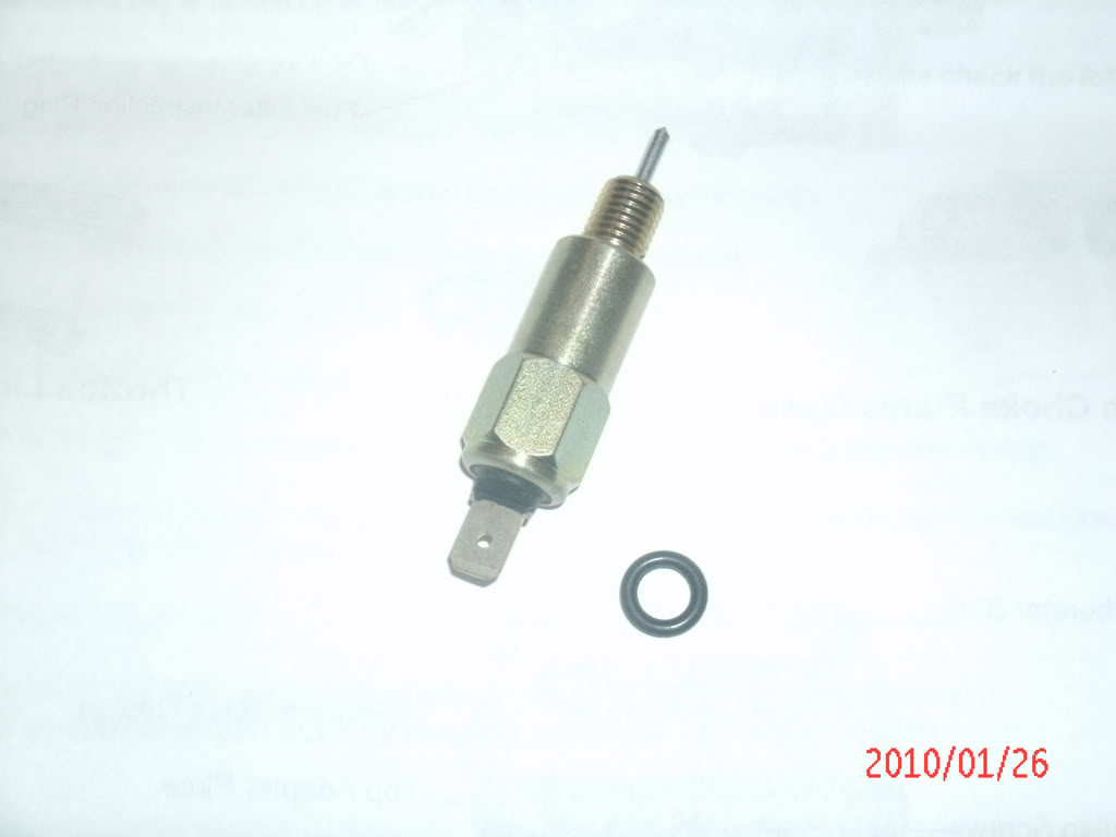

idle shut-off solenoid, yours is either bad, the wire is bad to it, or you need one put in. This is probably also causing your weird idle if you have one and it's not working properly since the idle fuel jet is also contained in this housing.

When I bought my 38 it didnt have an idle-cut on it. I purchased one just cause but webers dont need it, just need more tuning of the idle circuit. Even with the idle-cut installed if my idle circuit is not tunned right it will still diesel. Just follow weber specs on the mixture screw and jetting. Even an 1/8 of a turn makes a big difference on the mix screws.

um........
they do if you buy it.
I should know, I have one and broke it 2 offroad trips ago. Engine diesels without it and I am well within weber specs as far as idle/mixture screw settings go and have my timing set at factory 0 degrees.
http://www.webercarbsdirect.com/product_p/43914.060.htm

Where do you install this? Sorry for the dumb question!

see previous comment regarding idle jet.
