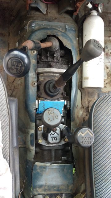

My tg twin stick been going strong for 5ish years now. No regerts. Bought because I needed to convert a fwd shift to a top shift and it wasnt that much more to add the twin stick.

I love the TG twin stick setup in my '85. When I first installed it, it would bang against the edge of the hole in the tunnel every time I started the truck or clutched it hard. So I replaced the stock trans mount with a stiff poly unit, that solved the problem. It's the 4wd arm that would get banged up if the trans mount wasn't stiff enough to keep it off the tunnel, so that could be the cause of the problem in this post. For my truck the twin stick unlocks a lot of functionality.

It separates high/low and 2wd/4wd into two sticks, allowing for 2wd low range. You have to take the transfer case apart and pull out a pin, so while the shifter does just bolt on, you have to disassemble the t case to make it work.
