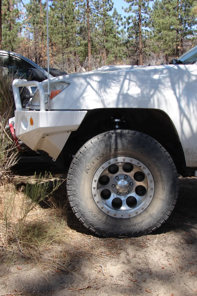

On the first picture (my wife's 2001) there is a hole in front of the 3rd clip which hold the plastic trim piece. Hole is covered with black plastic plug. Antenna is mounted using this hole to the bumper. This is very solid mount of an antenna.
To give you an idea:

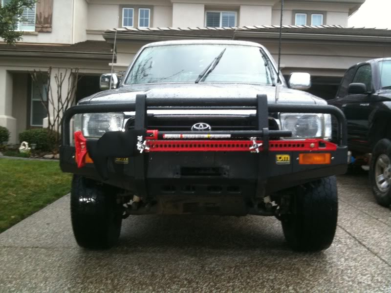

Old Feb 9, 2010 | 08:41 AM
MaK92-4RnR's Avatar
Joined: Mar 2008
Posts: 6,059
Likes: 101
From: Sacramento, CA
heres mine on a TJM

Oh, sorry, I meant the first picture on your 2nd post. I have those 2 little clips on my ARB on the top middle bar, I also just got my Firestik yesterday in the mail and noticed there isn't really any type of mount I got for it. I am interested in putting it in the same location though.
