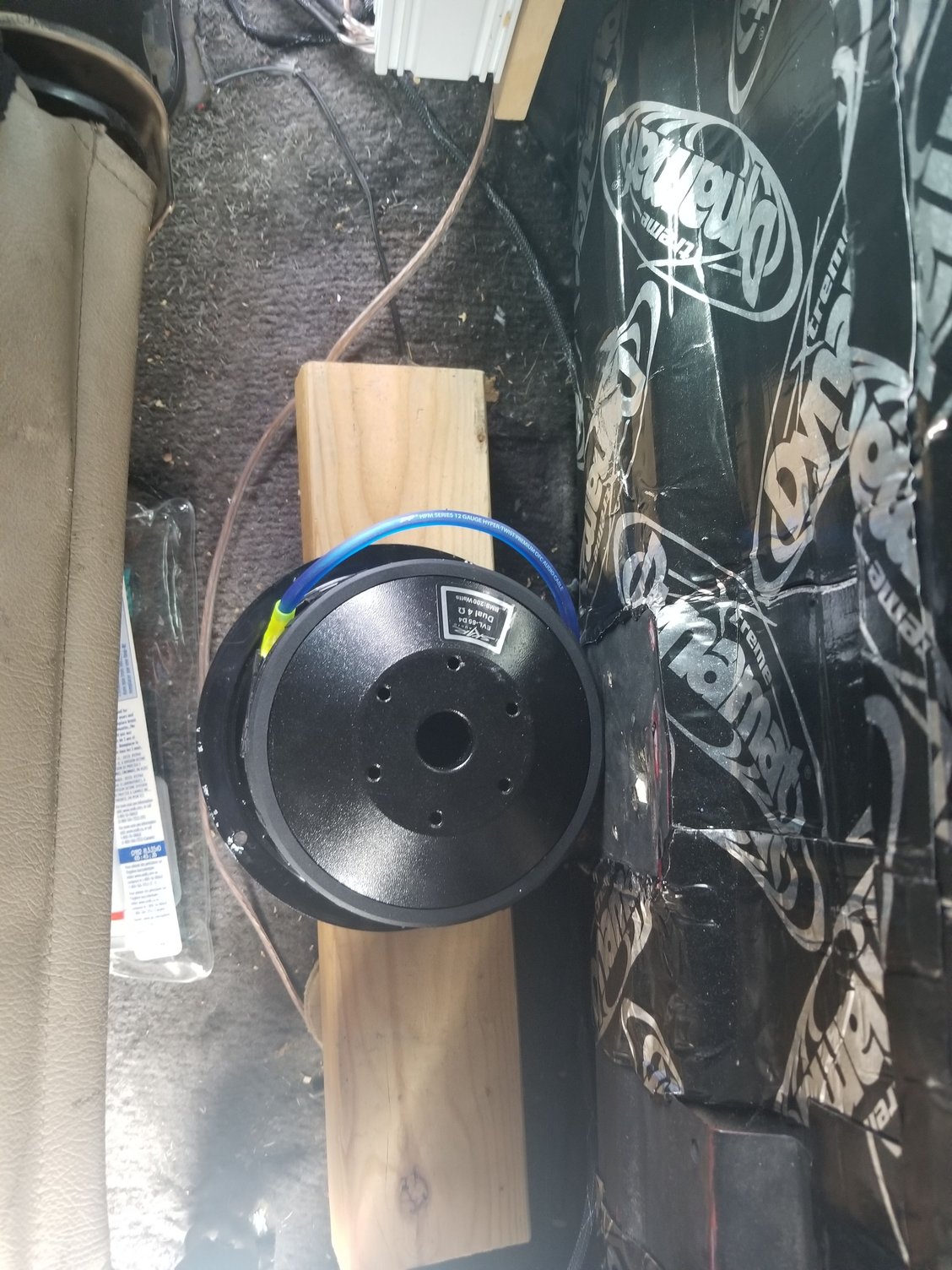

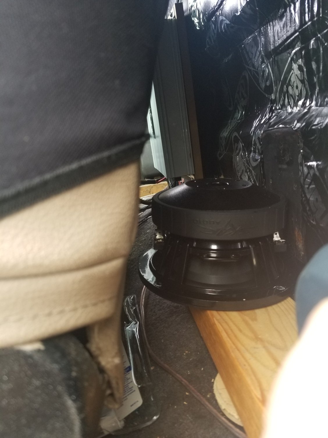

After some thought and visual aids, I'm going for the downfiring option! I borrowed a sub from my dads C-20 project, and it fits nicely.
Rough placenent of 6.5 sub
Side view behind seat, pleanty of room for possibly bigger box!

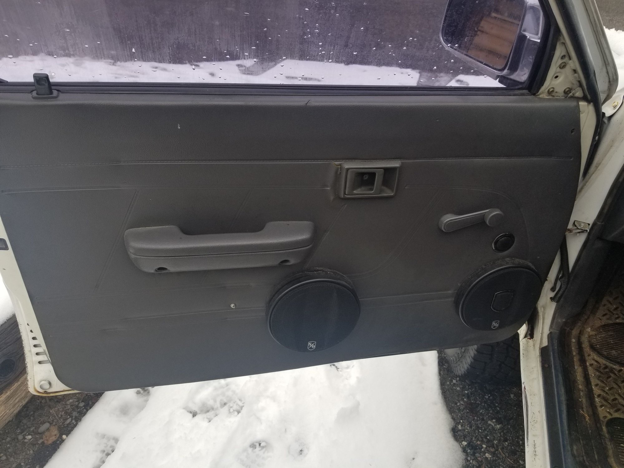

My experimental speaker placements. Sound ordinance 6.5 component paired with SO coax, 55w rated each, crossover hidden behind panel under arm rest

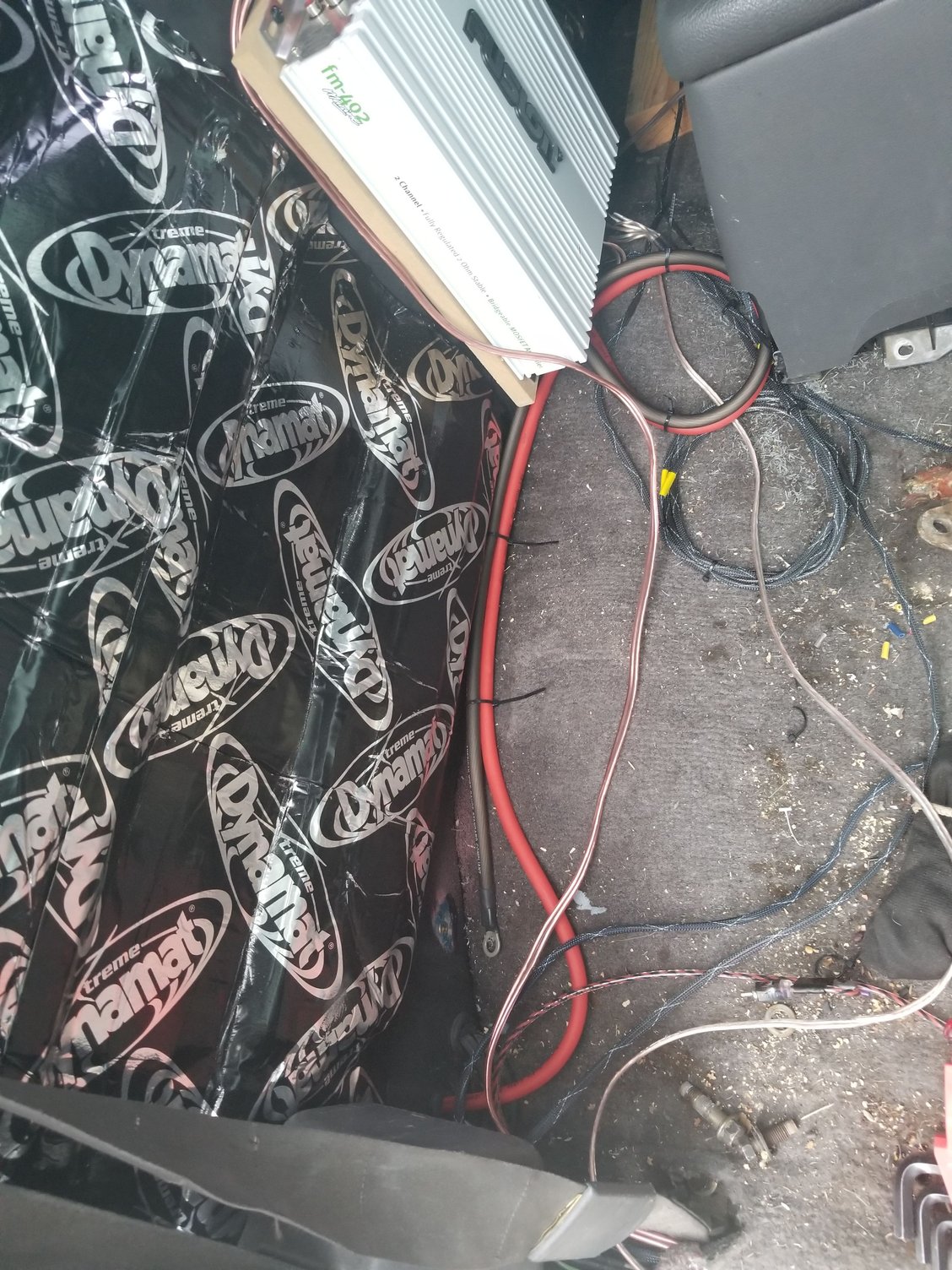

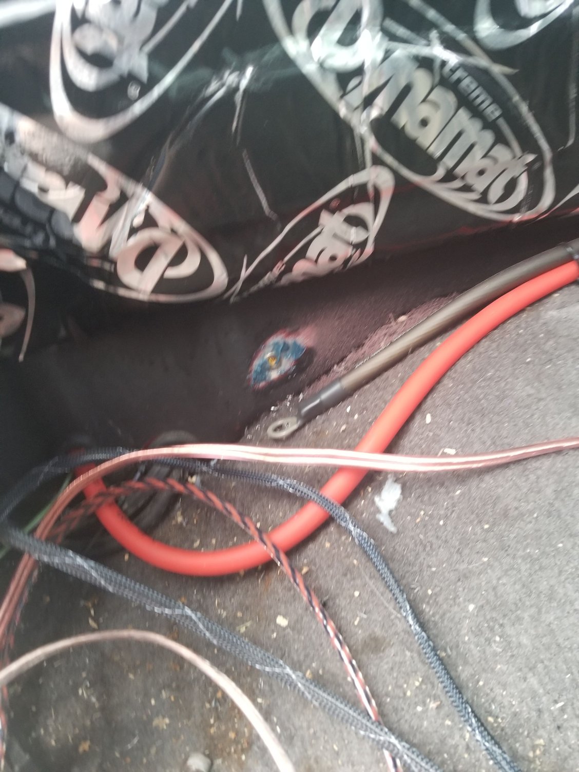

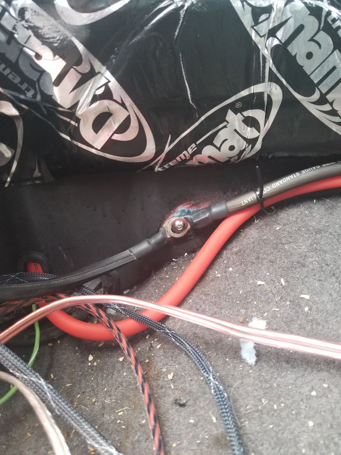

Amp power wire
I fixed my ghetto power situation, and installed 4ga power and ground from my 2nd battery, located in the bed of the truck. Hopefully I can find an indoor shop soon to build me a box and get some cable management done!
Cab ground for 2nd battery, also serves amp ground. Using 10-32 threaded insert for mount. Removed and replaced cab plug with grommet for pass through
Final dress if power cables, left the loop to pull amp for maintenance later on, will be using different amp

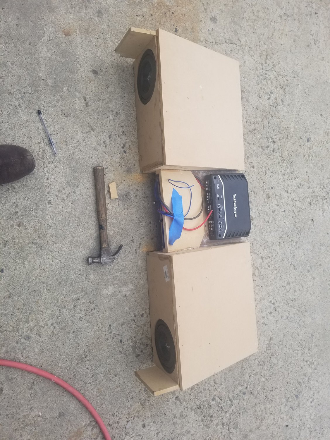

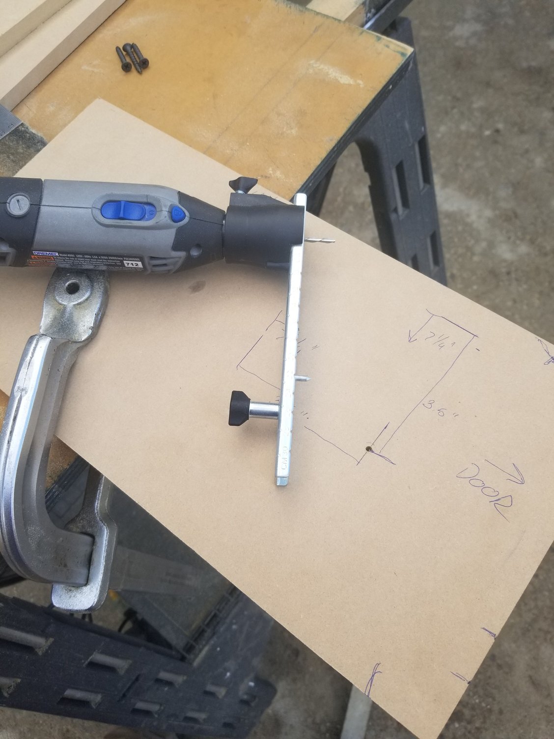

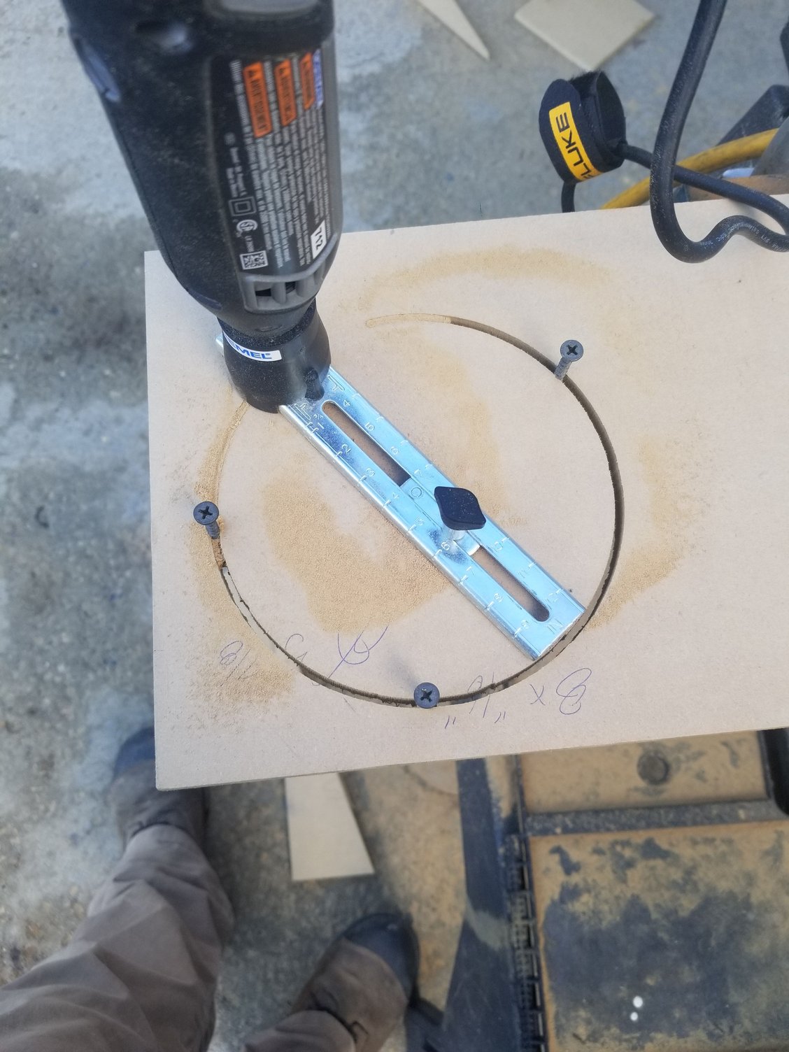

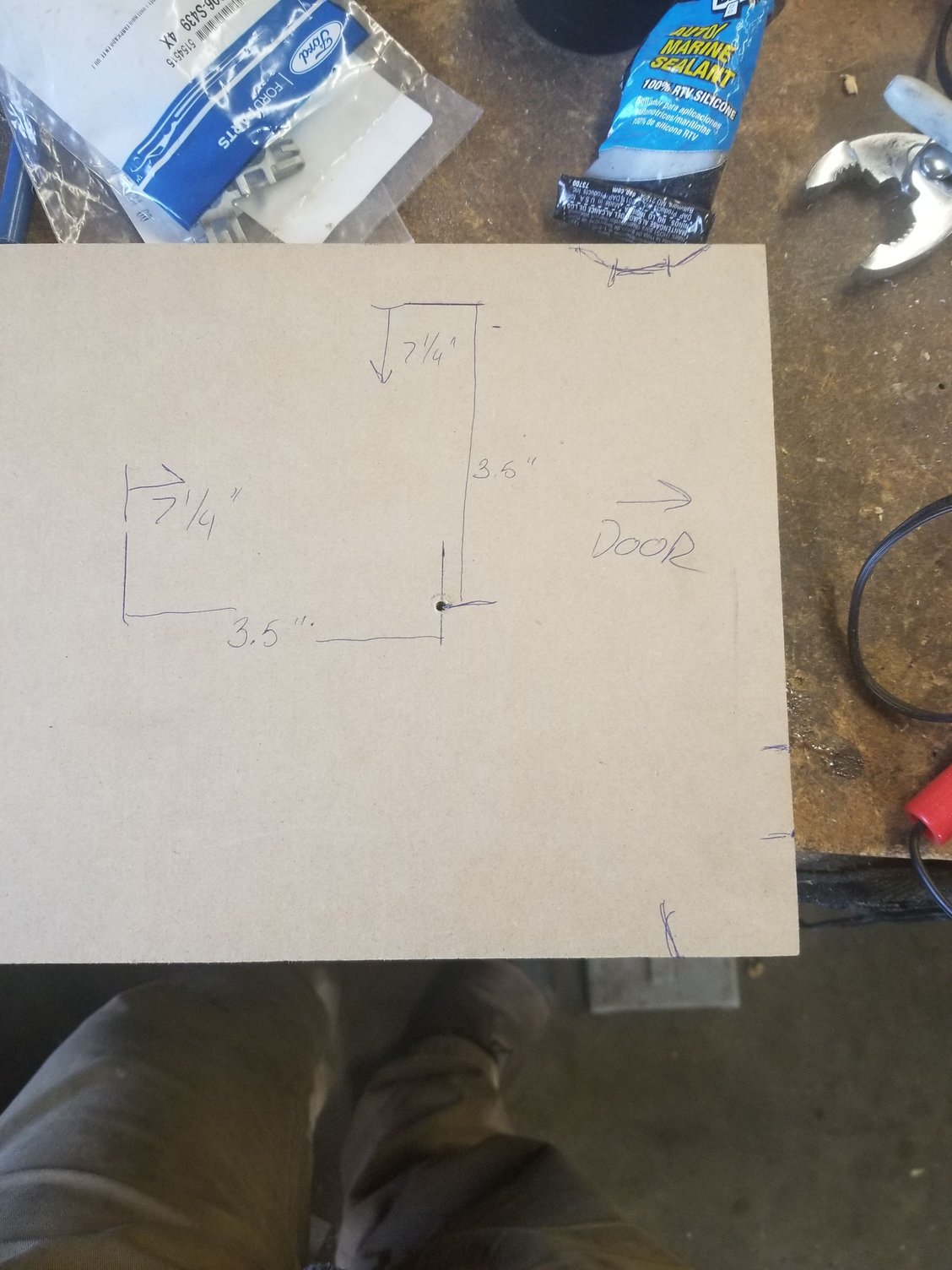

Talking Building "box"
Got a break in the weather, decided to get busy building! Being small speakers, I don't anticipate much flex while using 1/2" MDF, but I made a recessed baffle that is 1" thick and should hold strong! made four baffles, two with 7" holes, and two 5 7/8" holes, laminated a 7 on top of a 5, gain 1/2" extra clearance on the floor of vehicle while having a good strong mounting surface. In the process of making two boxes, one behind each seat, with an amp rack in the middle. Yes I could use the middle to add volume and go ported but the truck is the road warrier! The only thing kept under my seats is books, lost tools and hidden beer money! Plus, I learned that forgetting about your monster energy drink behind the seat overnight in the winter causes your amp to get all wet and gross.....whoops....
8"x16" boards (x4) two get 7" hole, two get 5 7/8" holes. Measuring the center for the speaker holes, will hide some under body panel, so left an inch on back side, measured 7.25 from front and door sides for center.
using Dremel tool to cut the holes, works great with thinner materials, going slow, bit overheats quick.....
using drywall screws to hold cut out in place, this keeps the cut out and center straight while finishing cut.
Passenger side outline completed, ready to work on the fiberglass back! speaker will be about 1" from the carpet, bit closer than I wanted, but seems to be the only place it'll fit without sacrificing leg room!
So......failures so far:
LOTS of trimming of baffles to sit where I want them, I forgot that the passenger side "hump" is taller/wider to accommodate fuel tank will have to massage the corner there just to make sure the sub doesn't make contact.
...speaking of making contact......I test fit a speaker, which fit PERFECTLY!! so perfect in fact the rubber protector around the magnet will make contact with the face board, but BARELY. like, I can get a feeler gauge in there, and it will clear if I cut a hair off with a knife, but I don't think it's necessary and I'm going to leave it be. Hole should move 1/8" toward the rear and would fit nicely!
rogue nails are from me putting one side of baffle too high on one side....had a heck of a time finding out why it wasn't square......good job me...
put ZERO thought into the amp rack, it will go in the center but I forgot to think that one through, I will likely end up putting a 11.5"x14" board in there to make everything one piece, fiberglass the edges for strength, this piece will mainly serve as a mounting point to cab.
not really a fail, but i have noticed more differences between the driver and passenger walls, I don't think the two boxes will have much (if any) difference in volume. I plan to use an acoustic tuner (band geek tools.....go trumpet section!!!) to get both boxes referenced, should be fun!

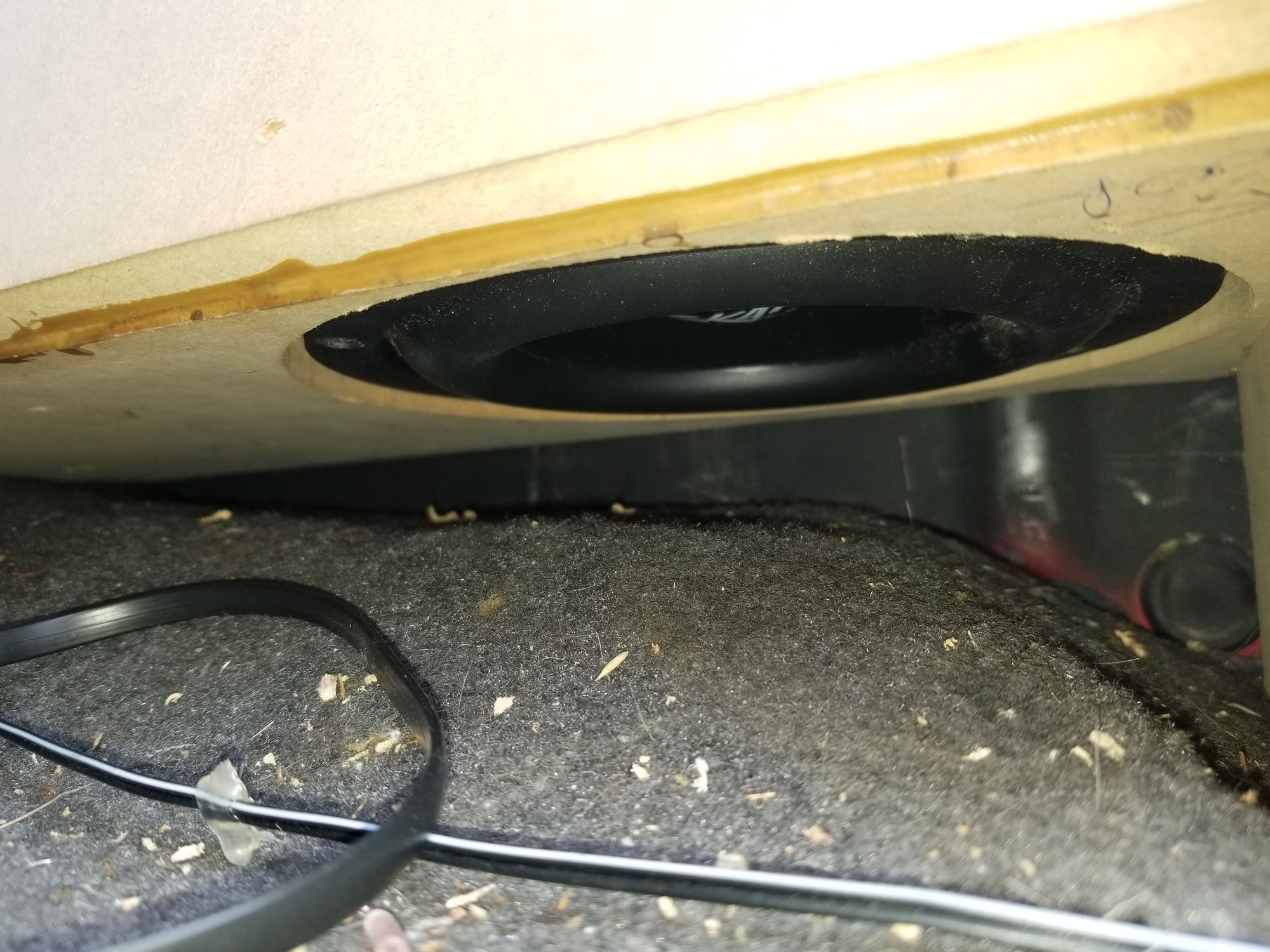

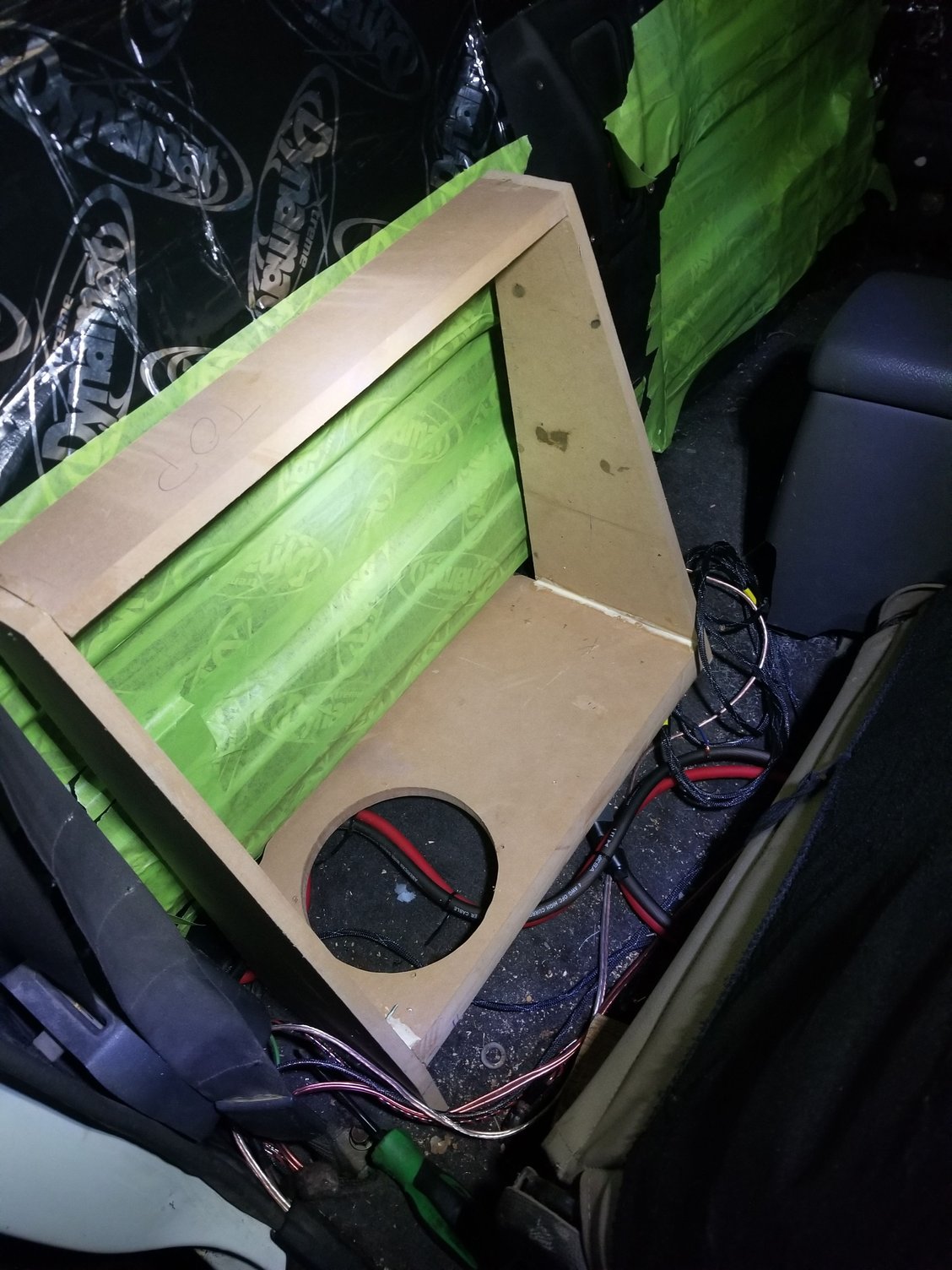

Success!
I got everything powered up and playing, super happy with the result!!
the subs clear the floor panel at full extension, nothing is rubbing, and they sound much cleaner than previous setup.
Box view with mid/high amp installed, made an angled base for sub amp to fit properly behind center console.
Both amps installed in final position

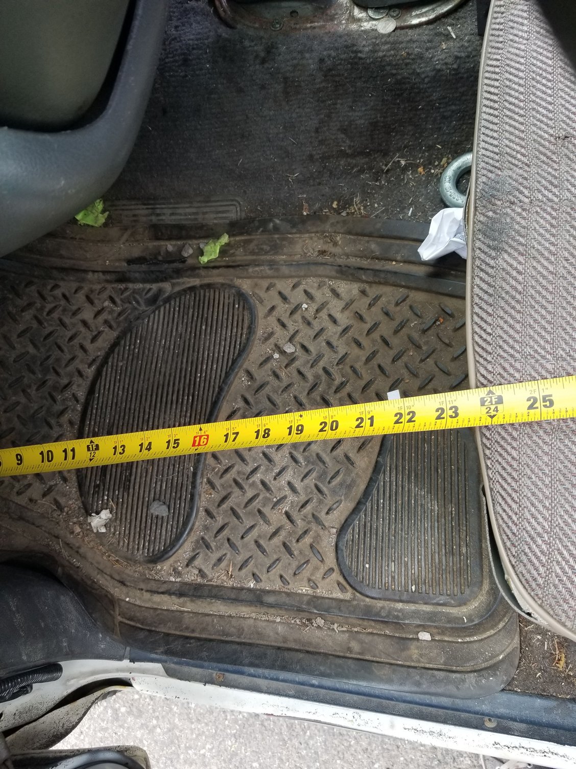

Reference measurement to back wall for seat position
Reference measurement to firewall for seat position/leg room
