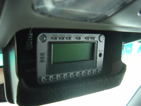

Time to consult the knowledgeable. The factory CD player in my 2000 4Runner no longer works so it needs a new headunit. In addition I want satellite radio. The Delphi Roady 2 is a nice unit and I’ve seen it cleanly mounted in the sunglass holder. What should I be looking for in a headunit?

I just installed a Sirius One sat radio in my 3rd gen. I spliced into the map lights for power. It's a very stealthy install, and the radio tucks in nicely between my sun visor and the headliner. It's a bare bones unit, but it's small (about the size of a small radar detector) and only two wires to hook up.
For the antenna, I mounted it at the back of the truck and tucked it under the trim along roof on the passenger side of the truck. When I got to the right-front corner, theres one inch that can be seen where the wire jumps out of the trim and into the passenger sun visor hole. (Be careful! If you disconnect the wire that powers the sun visor's light, it'll try to disapear on you. I would recommend a long cable tie to leash it, so that when you go to hook it up again, you can pull it back out even if it's dissapeared into the hole.)
Then the antenna wire exits same place as the power wire on the driver side of the map light/sunglasses console. The two wires come out for about 10 inches, where they snake around my visor and get into the radio.
Overall, it took about 4 hours, and it's relatively well hidden without any major mods.
