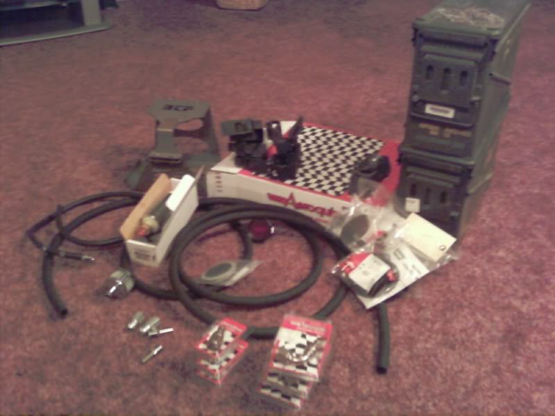

well i havent updated for a while because i havent really had time to work on the 4runner, with all the snow and floods i have been having to use it as a dd and i was in canada all weekend, but anyways ive been gathering parts and i have pretty much everything to hook up the fuel cell i got my straps for mounting the shovel and axe i got some ammo cans to put on the bed also and i pretty much have everything i need to rebuild the 8274 that ill be putting in the back. so heres a pic of my parts pile

ill probly start working on hooking up the fuel cell this weekend

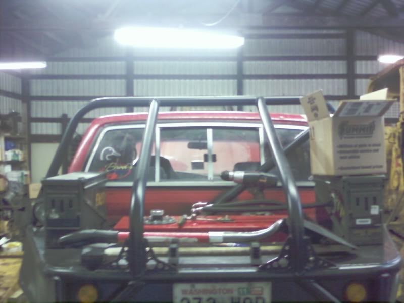

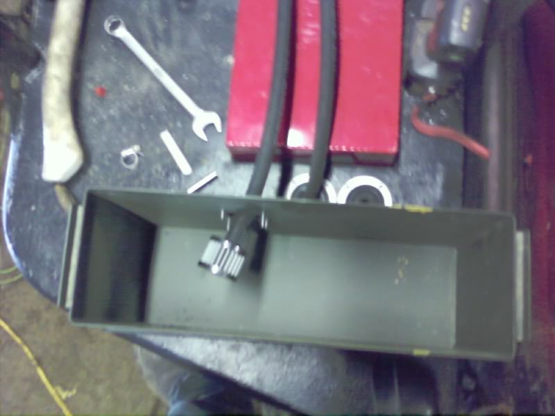

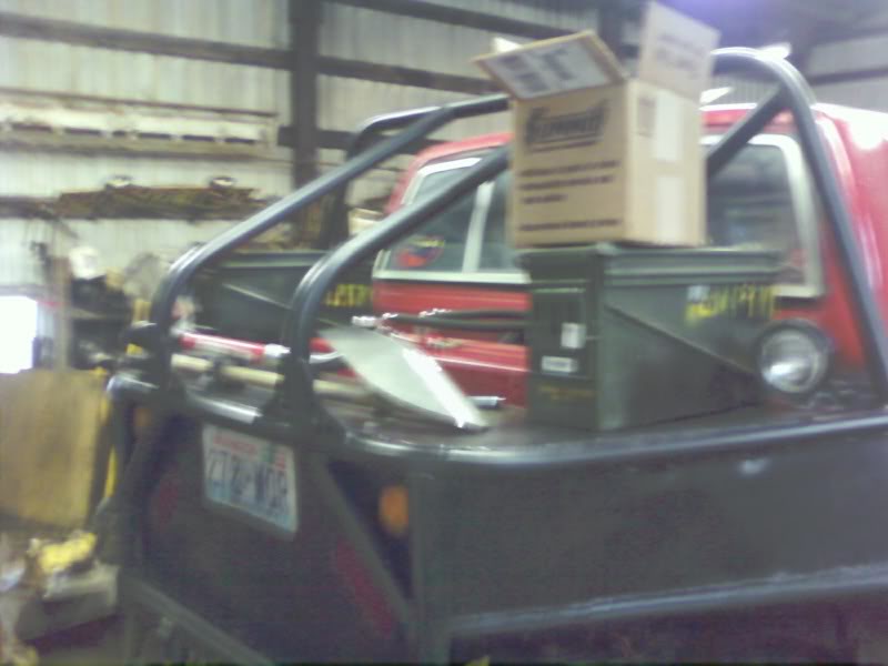

well i finally made some progress. got the ammo cans mounted, mounted fuel pump, plumbed the fuel pump, put some rear lights on, and put on the axe/shovel mounts.
i decided to put the fuel cell breather filter inside an ammo can so it would stay clean and dry. heres some pics

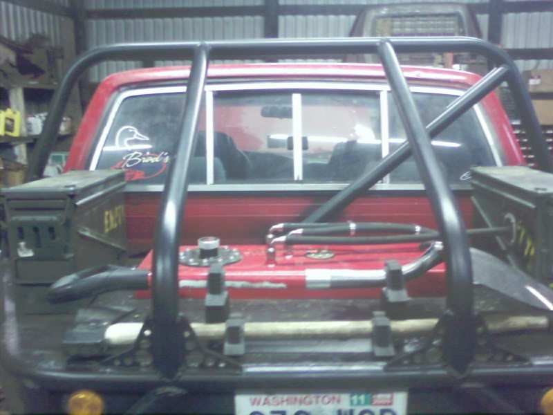

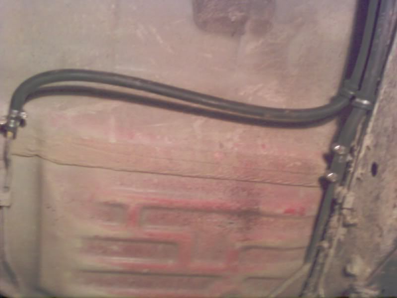

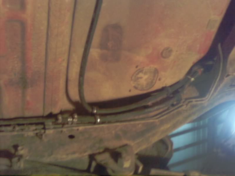

today i got everything plumbed, and finally put my shovel mount on. heres some pics of how the fuel lines are ran in case anyone wanted to know how i adapted everything
and the shovel mount

now all i have to do is wire the fuel pump and put some gas in the fuel cell and hope that everythings works the way it should. Oh and i should hopefully be getting some more tube to do the rest of the exo within a couple weeks so thats my next project

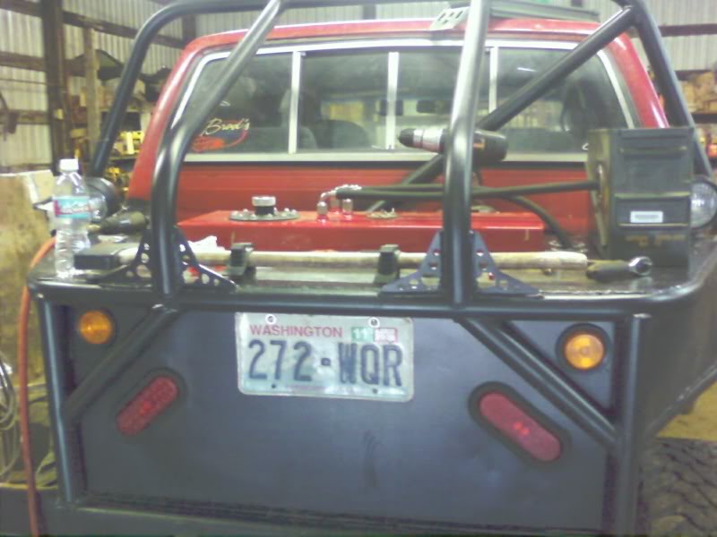

well today i got the fuel cell and everything finished. it only took about 3 hours to solve a slight problem. what happened was the tank had the labels switched around for the return and pickup, i figured this out after checking the fuel pump to see if that was bad, and after checking every hose to make sure they werent plugged, that was a pain in the ass. so theres a lesson to anyone installing a fuel cell, you cant trust the labels!!

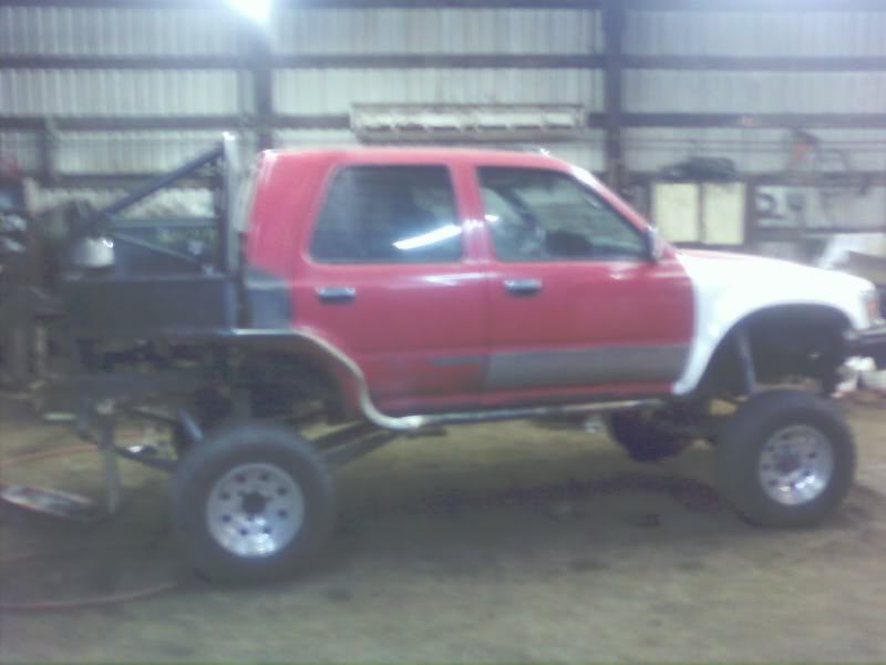

what do you guys think about my new rubber??
haha just kidding i sold my old wheels and ordered some black steels and kore weld on beadlocks, thats the next project
