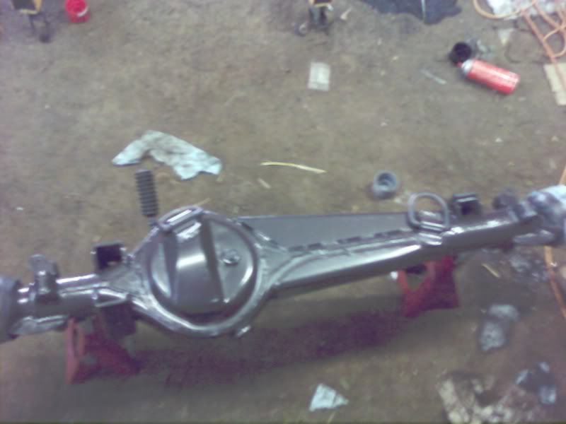

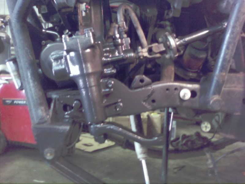

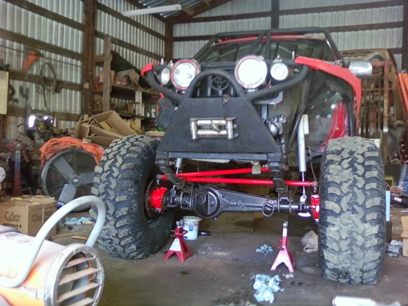

ive gotten a little bit done.
moved the steering box ahead about 3 inches
made some knuckle ball and steering stop gussets. redrilled the perches about 11/2" back, welded on some d rings and repainted the axle

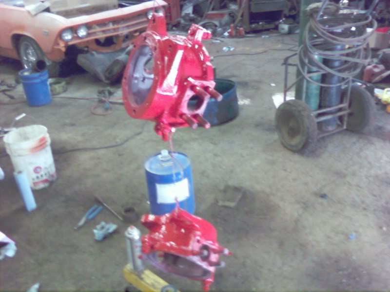

and cleaned up and painted the knuckles
should get the axle mostly back together with the 30 spline longs and trunion bearing eliminators tomorrow

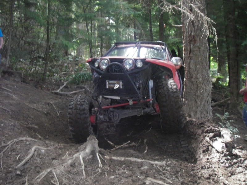

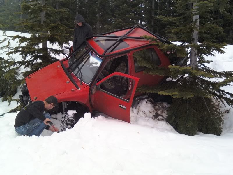

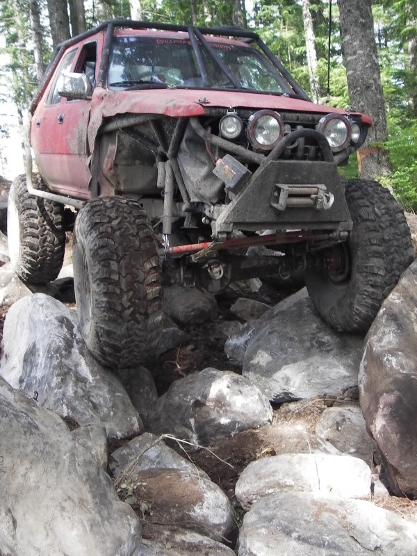

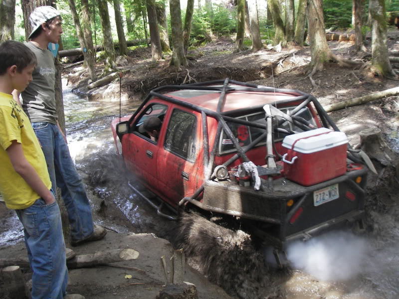

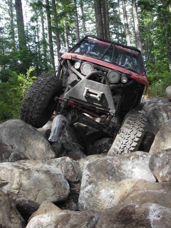

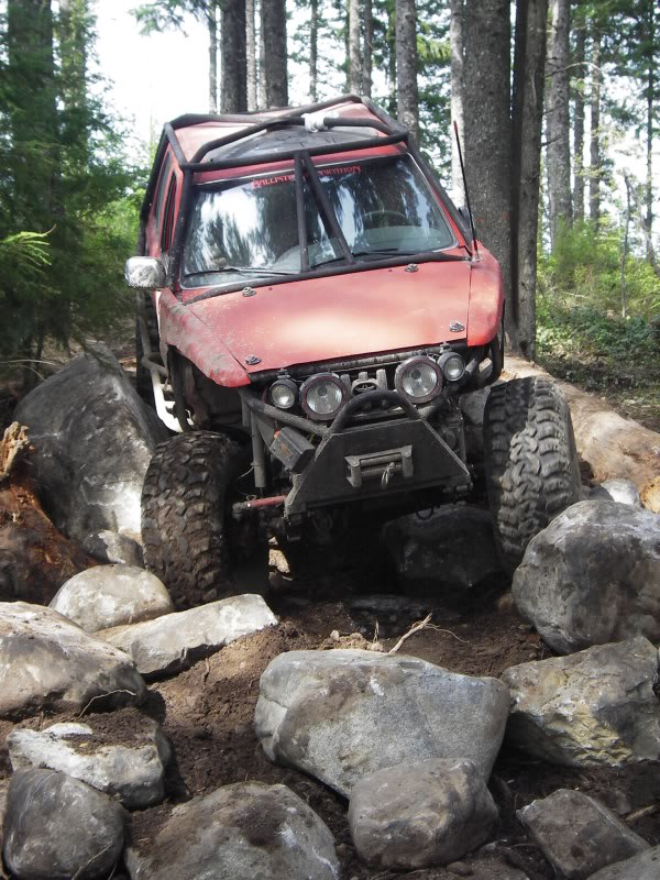

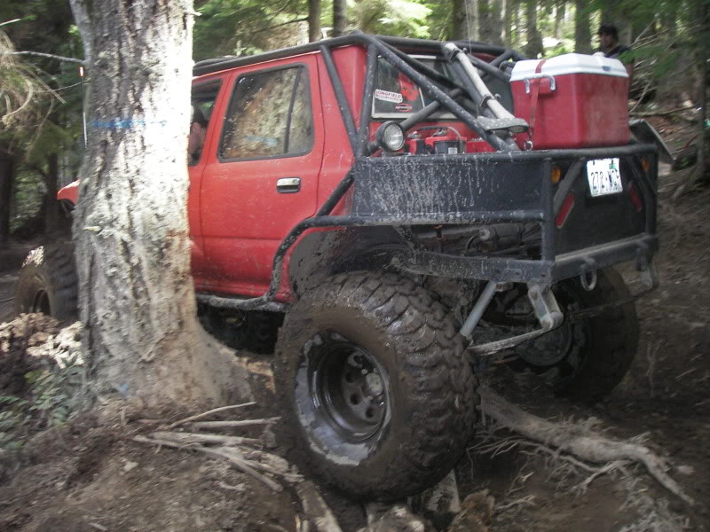

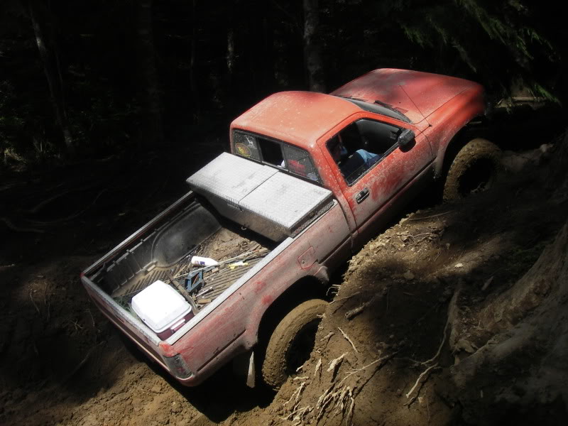

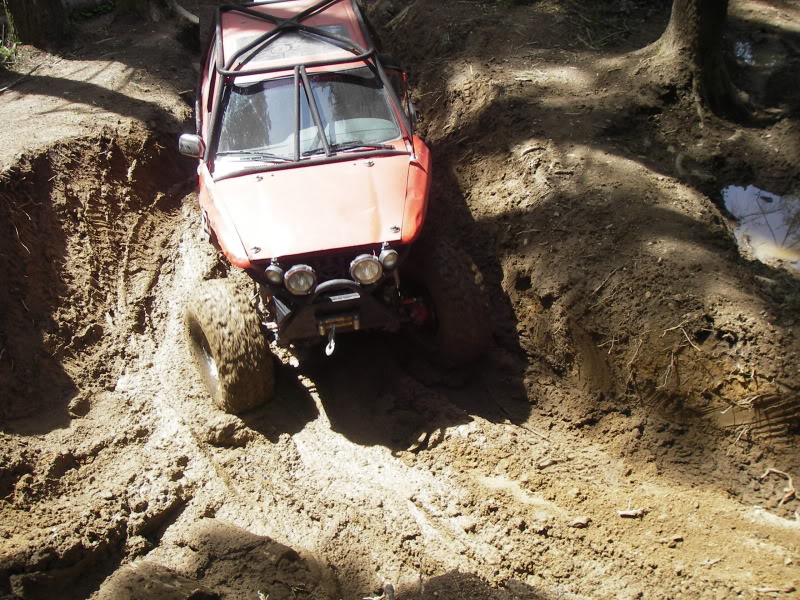

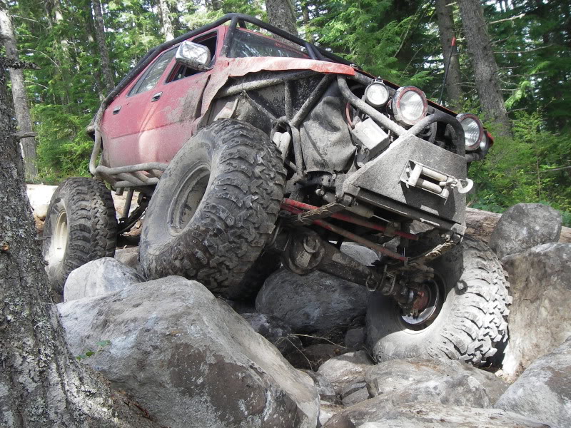

went wheeling out at elbe hills this weekend so i finally got to take some wheeling pics
