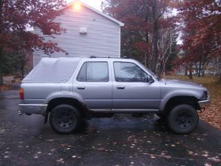

here's a pic right after i chopped it, still have some minor finish trimming to do. found out today the soft top plan is out. the upholstery guy wanted to charge to much to have made. so now i'm back to my original plan, sealing off behind the back seats. as for rain, i wouldn't worry much, a couple of guys who have done this said the only time the had any moisture issues was with the pressure washer. my truck is also a daily driver, but i have 2 other vehicles at my dispense. i'll keep you informed of my progress , again, really a great project you have going there, keep up the good work! Name:  004.jpg

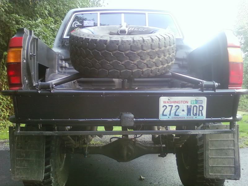

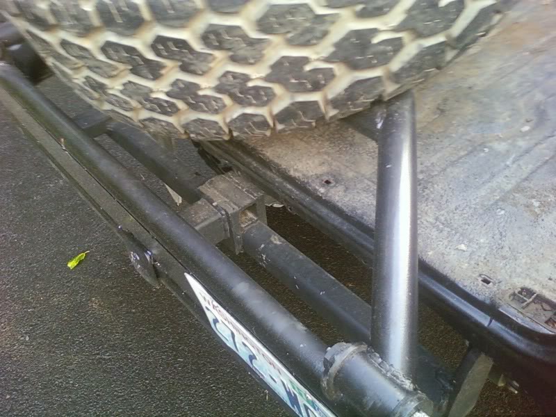

did some work on the bumper today. started to get it plated in but i ran out of plate so its not quite done
my plan is to plate in this part
and make it so its like a box without a top to throw towstraps and whatever else in there

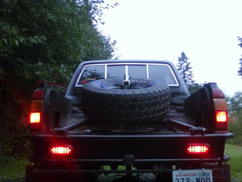

stuck some lights in the rear bumper last night

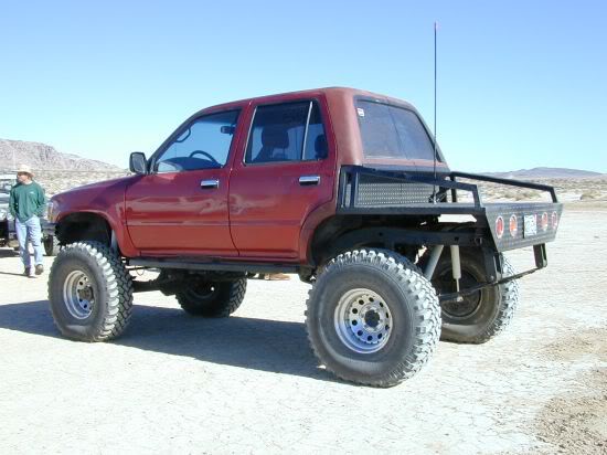

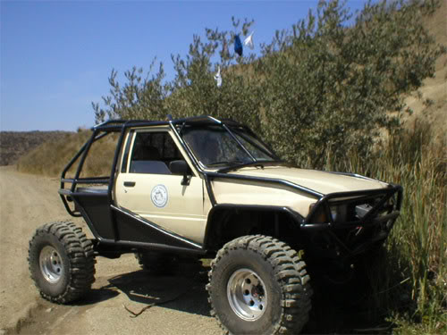

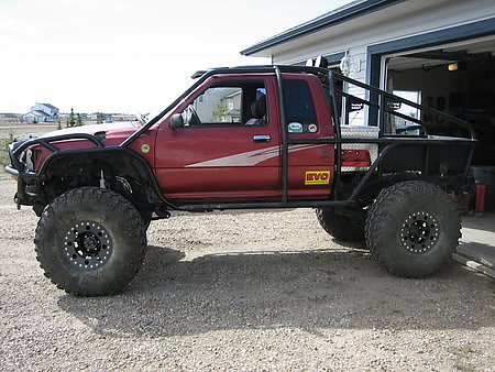

here are a couple of ideas...

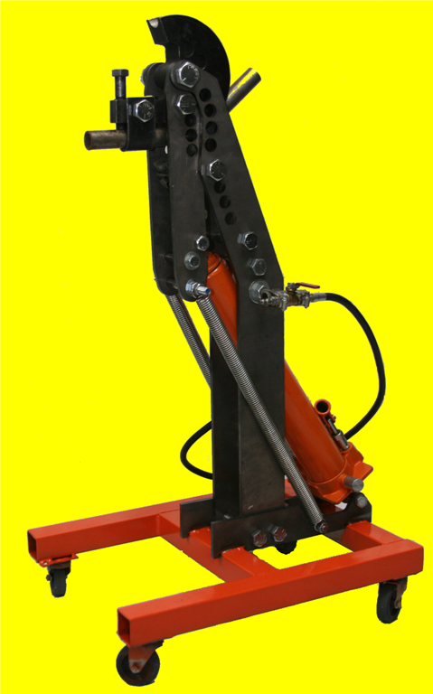

heres the bender i decided to go with
its from www.probender.com

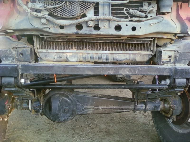

well today i started getting some stuff ready for the exo. didnt get a whole lot done today but i got the front stock crossmember where the bumper bolts onto all cut out, and i got the new pieces cut that will replace it. 2.5" x 1/4" square, should be plenty strong and now i wont have to worry about the stock one bending once the exo is tied into the bumper. i only managed to get one pic here it is.

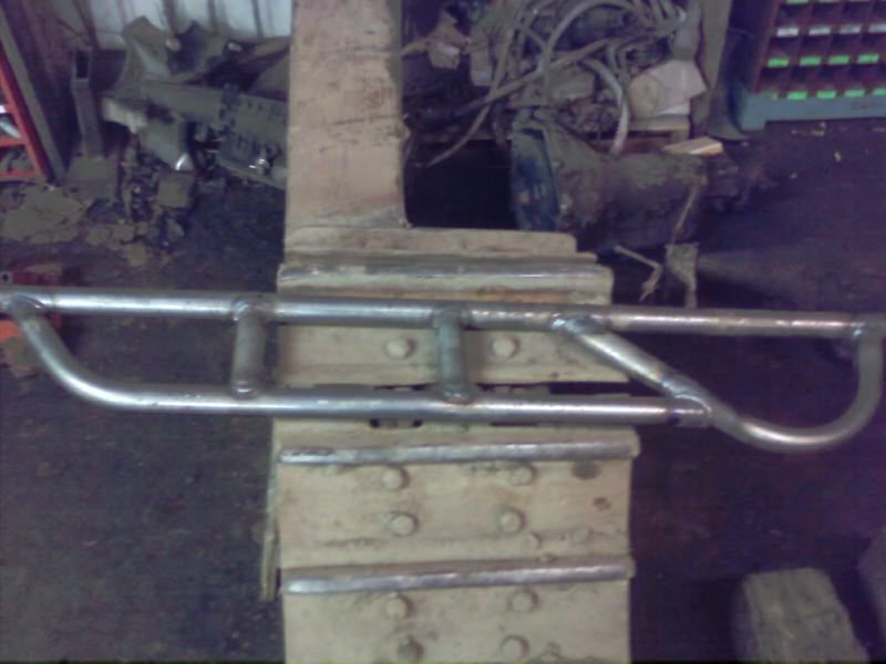

well i havent posted any updates for a while so i think its about time. i finished building the front x memeber, which im pretty happy with, ill take some pics tomorrow, and i also got my tube bender so i got started on the sliders, got one done then ran out of tube but i should have some more tomoorrow so maybe i can get them on this weekend. oh and i decided that i am going to cut the bed completely off then build a tube bed and cut out the bed sides from the original bed and use them as skins do it will have the it appears to be stock look.
heres what the sliders look like
