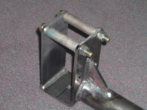

these are our bolt on mounts, they utilize the u shaped bracket, with bolts over the top of the frame and sleeves to prevent over tightening, the mounts are also predrilled for 3 self tapping bolts, 2 for the face of the frame and 1 for the bottom of the frame, this is in our opinion the best way we have found to bolt a set of sliders on.
if you weld them on be carefull what kind of scab plate you use, straight vertical welds on your frame are a bad idea, the plate should be shaped like a diamond or curvy like the ones in the pic.
I feel that weld ons are more durable in the long run if installed correctly
I helped install a set of CBI sliders on one of the OHTTORA guy's Taco the other day, and have to say this is a pretty nifty way to install sliders. My only beef is that there are all those ridges to get hung up on where the U wraps under the frame - which would be even worse if you install the bolt in the bottom. I think it would be really cool to have the bottom of the U be one long piece connecting all the supports and providing a smooth surface.
