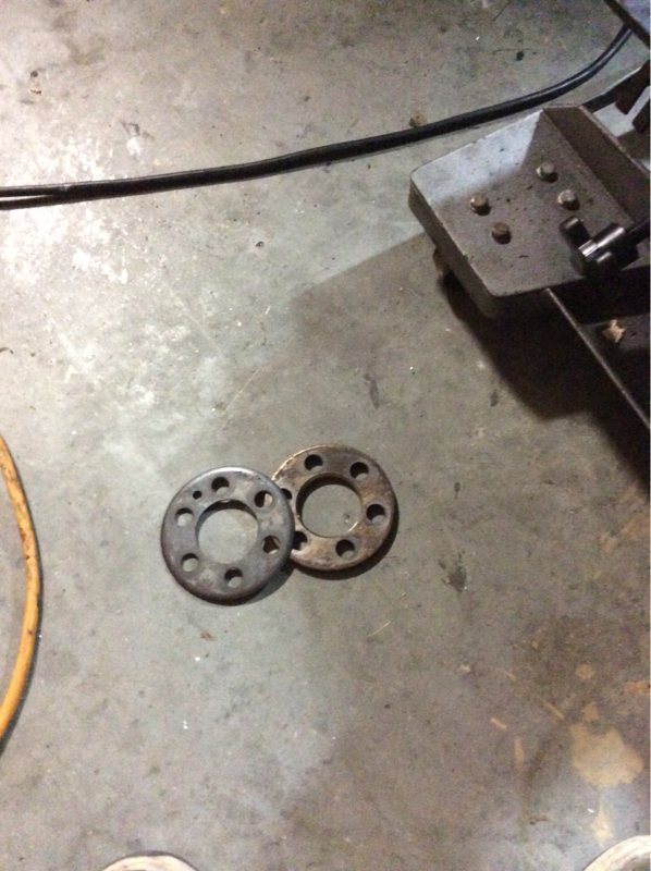

Ok so dumb question maybe it's because it's midnight and 95 degrees outside but my brain's not working. I'm finishing my auto to manual trans swap, do I need to put these back on, or just bolt the flywheel to the back of the crank?
Thanks

I am not a big auto Trans person .
I have never seen spacers behind a fly wheel when replacing any.
Just bolt the flywheel up .

No, there only used with the auto's flex plate.
I had the same question with my 3.4 auto to 3.0 M/T swap: https://www.yotatech.com/forums/f160.../#post51884518
Flywheel bolts directly up without the spacers.
