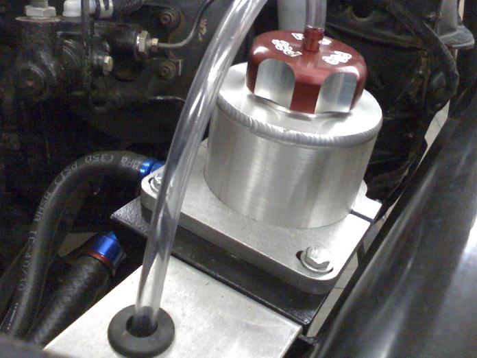

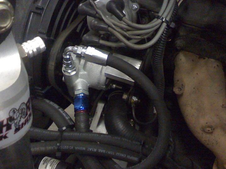

Well after a few years of running the "home made" X-over steering I finally reached the limit of the stock arms and they started to crack at the stud holes, so I decided to get myself an early Christmas gift. I calld up Brandon at RIDES and had him get me a full PSC hydro kit. I got it all put on and took a few pics of the install.....
Pump
Steering valve and mount....
Tank...

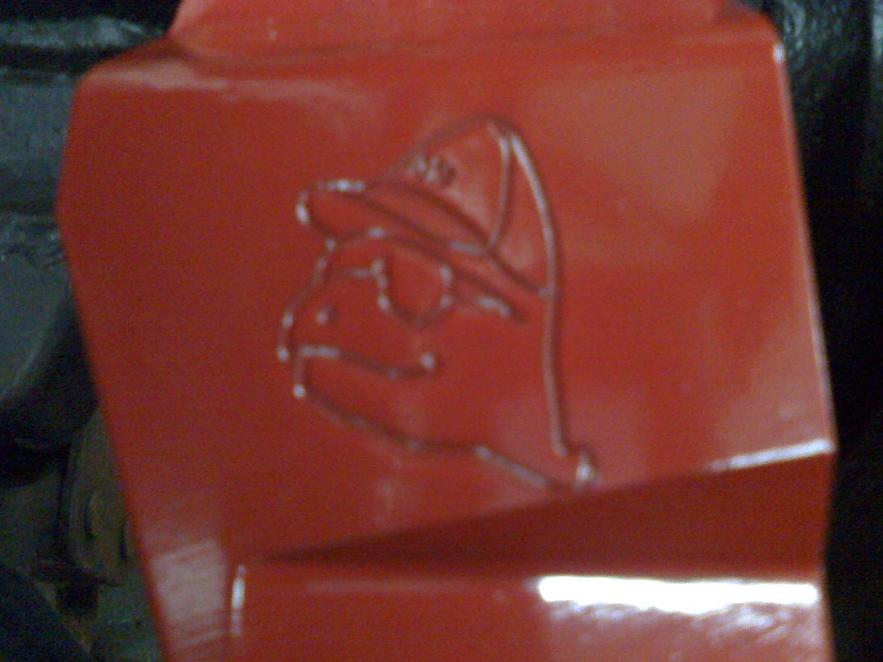

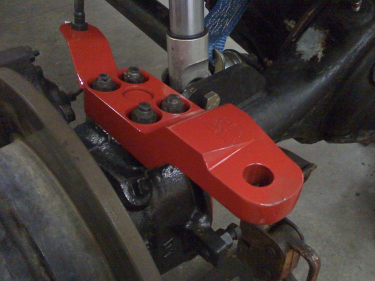

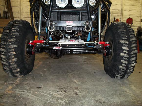

Once I got that all worked out and plumed I put on the new high steer arms from Marlin Crawler and made the tie rods...
I added some brake line mounts to the arms as well as cut down the pass. side arm
I got a Turtle head.
The ram ended up being offset to the driver side a little so the tie rods are different lengths...

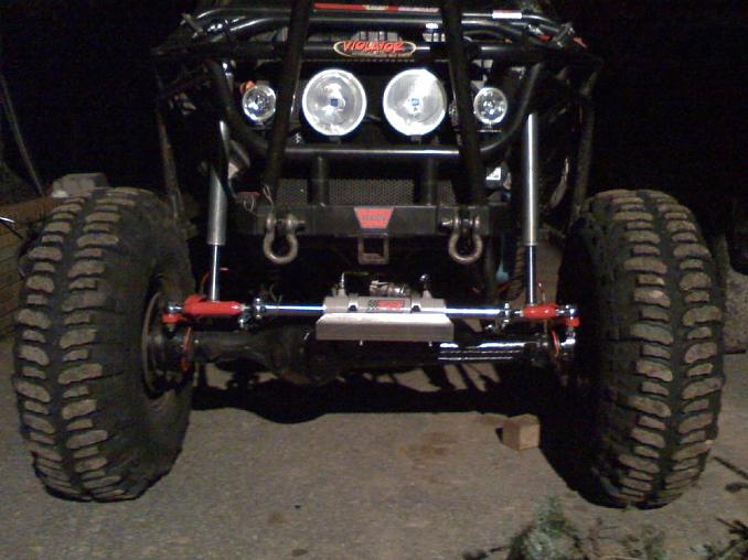

Got the tie rods on and got every thing bolted up...

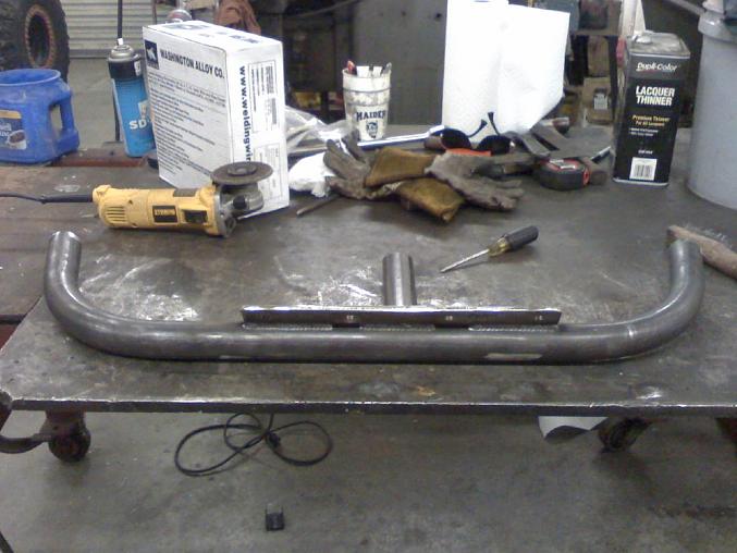

Went over to MUDPRO metal works and bent out a ram guard made out of 1.75" .1875 wall DOM and welded a flange to bolt the front face of the ram mount.....
Got that all welded up and put on.....
Let me know what yall think. Thanks. New guy here.
Attached Thumbnails PSC full hydro-done.jpg   PSC full hydro-guard.jpg   PSC full hydro-picture-091.jpg
