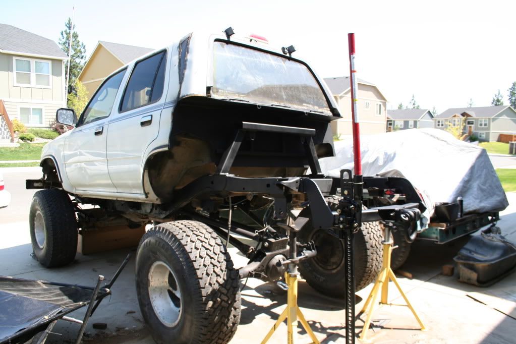

In these pics, Ive taken the axle off, I have my dropout complete and gears are all set (Thanks Wayne!), Ive ripped out the interior, and chopped the rear side of it off. Tomarrow I will drain the gas tank and take it off to be relocated after Im done with the cab fabrication and rear suspension. I was planning on fabbing up the new crossmember this weekend but it will have to wait until Thursday, the shipment on my new plasma cutter was delayed. I think Ill start working on the front side until it gets here, Ill try to have the knuckles rebuilt, the aisin hubs put in, shock tower mounts ground off, and the cracks in the frame fixed.
........... BTW I think all my neighbors hate me now.... 8)
got my gas tank removed and cut out the spare tire crossmember, ill need to cap that off with a new cross member on the end to reinforce it.
mocked the new mount in place, welded it in- only tacked the lower link mounts incase they need adjusted

Got the rear axle together with wheels on, slid it under the truck so we can mock it up soon

ok sorry for the long wait on updates but college has been keepin me busy. After fixing the leak on my gas tank I moved the lower coilover mounts further out and crossed my fingers that it wouyld still clear on full stuff...
It worked! I have like a quarter inch clearance still, just barely made it!
Then i framed out the bottom portion of the rear window and put a gasket on tjhe lower portion to make it look finished.
next I framed out the flatbed
Then I put in some cross members to support the bed and put on the rear of the flatbed
Next I cut a hole in the floor to make room for the crossmember i built on my links so that I could take off the 3" body lift- I accidentally cut through my arb air lines and had to get a union from granger to repair it
I fabbed up a cover for the hole which I will later fiberglass in (when I tare out the carpet in preperation for lining the tub with bed liner)
At this point I decided it was time for a test run!

Welded everything together
I am working on welding the bottom in, designing how to make it look finished- I have an idea that may look amazing- and welding that weather strip on the bottom.
Anyone know what this thingy does? Its some kind of hook that went on my track bar and is mounted to my brakes...
Cut these old bump stop mounts off
Here you can see my paint on the cab back and the cut out bump stop panels
Painted my axle
Building new upper arm mounts
Built my links
Built my suspension mount- thinking im going to either make another arm that goes back for more support, or gusset it..
Put my hybrids together - BOOYA! Trying to imagine how they will move with bump and droop
Heres some pics of the truck without all those tarps and welding screens around it
ok all updated... Im stuck right now waiting for bolts to come in the mail and Im still trying to find an 18mm drill bit...
/rant on
To all who decide to do this DO NOT BUY 18MM CREEPER JOINTS!!!!!
I called over 50 stores, apparently nobody in the US makes or sells 18mm, they go from 16 straight to 20, machine shops charge 100 bucks per to make them since they have to harden each one and machine each one 2x, fasteners can get them but the shoulder is about an inch too short, and finding an 18mm drill bit is just as rediculous.... Why trail gear would sell me an 18mm creeper joint without mentioning these issues is beyond me... maybe they hate repeat customers? /rant off...
Once I get these things the links will go right in, my coilovers are all set and ready to go in, and I will get started on the gas tank.
Im debating on letting someone else do the bodywork so it actually looks decent, Im going trade of all the chrome for black, and I think Im going to take it down to the local maaco and get a $300 dark grey paint job before I build my exo.
Here I am trying to fab some new link mounts with multiple adjusting points, wewt I got to use my drill press!
Using the old mounts I had fabbed for comparison I checked to see if my 45/64 drill bit would work well or if I would have to step it up to a 23/32 bit
Heres the new mount, it works!!! It was a better fit than the original one.
Got these all drilled ready to go in
OMNOMNOMNOMNOM! LUNCH BREAK!
After lunch I hired some help- She works for cookies! and apparently shes an expert in the field of tires?
Got one link in... had to pull the axle to drill out the holes (they were 9/16 holes)
Links in! Just need to weld up the upper frame mounts tomarrow, I decided to wait until I could see to do it.
So tomarrow Ill see about making brackets for the coilovers and putting in the gas tank.
I went to tighten all my links and I didnt have the right size wrenches- It was Sunday and nobody that was open sold it, so I decided to open my own line of tools!
Got my brackets made and jacked it up to put the hybrids on
I had to put blocks on the jack and my high stands didnt go high enough to touch it- and i still had to fight the coilovers by fircing the springs in place because theyre so damn long
Got em all set, just need to take em down to altons tire to get some nitrogen
side view... stance is a little high in the back but it will settle when i build the flatbed tomarrow.
Had to trim one side of the gas tank lip to get it to fit but its in!
got the gas tank all hooked up, poured gas into it, and she fired right up!
cleaned up the wires and lines so they dont get smashed
My gas tank's drain plug was leaking like a trailer park mobile home, I struggled with it all day- I ended up getting some heat resistant thread sealant- sets in 4 hours, completly set in 3 days. I am going to leave the gas tank empty until its fully dry while I complete all my welding on the flatbed and bottom of the rear window. I went through the rest of the truck finishing up maintenance stuff, bled the brakes, gave it a good lube order, double checked every bolt I put into the rear end for tightness, put some sealant on my welds, and hooked up my one remaining brake light- it worked! In 3 days I should have my flatbed finished and it will go away to the body shop where it will get some new front fenders, some body work omn the rear chopped up portion, all chrome will be replaced with black body parts (grill trim ect.) and some new paint- dark grey. When I get it back Ill build my front bumper, fill in that gap from the body lift, and start planning my roll cage. Im considering going down to the local car audio store and letting them put a big sticker on my back window in exchange for tunes and installing my cb somewhere on the dash instead of my floorboard. Ill keep you guys updated- after I put 500 miles on the new gears in the rear end Ill post some test run pics for sure.
This is where we visited
Here is my truck in action!

I have finished most of the flatbed here, I wanted to show how I tied it in to make a wheel well
Started the body work
yesterday I broke my axle driving on pavement... wth?
Almost finished! Ill keep you guys up to date here and there, be patient and stick it out!
I finally did it, all finsihed guys. Heres the final pics, hope you guys like it as much as I do!
