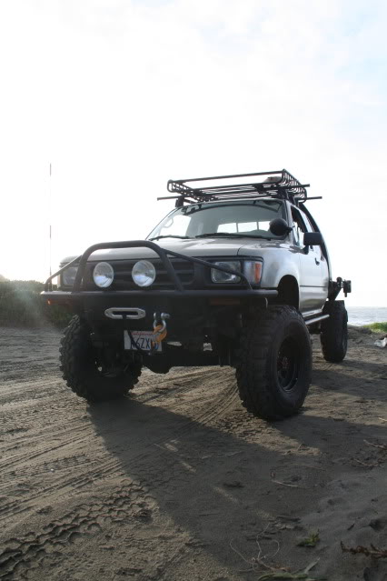

all said and done mine was around $5500.00
