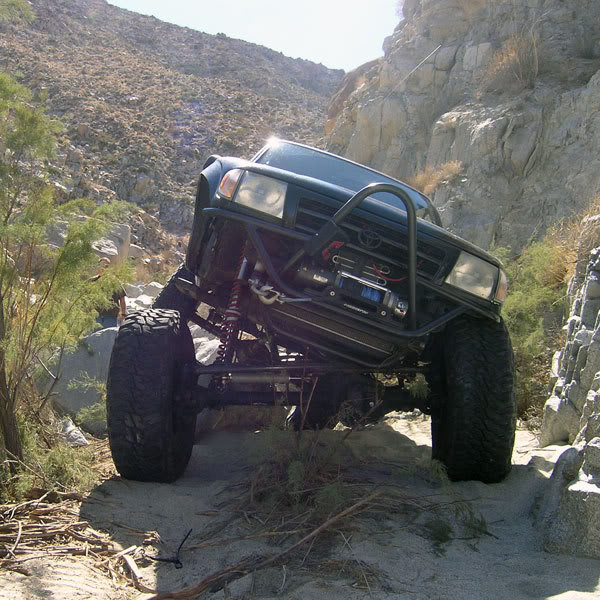

I stopped counting at 15K and guess around 20K and still climbing...
Truck Model/Year: 1998 Toyota SR5 Ext. Cab 4X4 Non-TRD
Engine:3.4l V6
Tranny: Auto Stock
Transfer Case(s): Stock with Marlin Crawler 2.28:1 Twin Stick
Front Axle & Gear: D60 King Pin 69"WMS 5.13gear 35 SPline Chromos 300M Super joints BTF Kingpin Arms w/Lockrite
Rear Axle & Gear: Full Floater Corp. 14 bolt 5.13 Gears w/Detroit & BTF Disc Brake Kit w/ Cadillac Disc Brakes
Front Springs: 17" Bilstein 9100 Coils rebuilt w/progressive valving, 3 Link w/2" .375 wall & Johnny Joints
Rear Springs: 63" Chevy Springs 14" in Bilstein 5150's Bud Built Banana Shackles and Hangers
Tires & Rims: 40" Goodyear MTR Rock spiders on 17" Black Steel
Frame Mods: Front frame plated with 1/4" steel, custom T-case Skid/link
Body Mods: Custom Front/High Clearance Rear Bumper & Sliders, Fiberglass Fenders
Other Mods: On Board Compressor/3gal tank. Alpine radio/speakers/amp.
