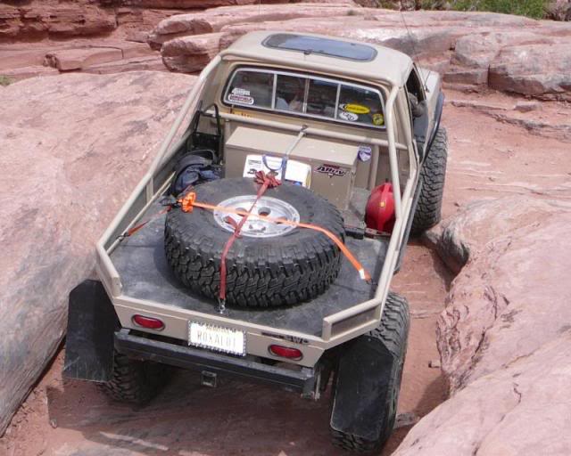

What is a reasonable price to pay to have a flat bed done like the one below minus the roll bar?

thats a pretty nice one, and metal is expensive. i spent 250 on just metal for my front bumper, and over 200 for the rear.
rough guestimate id say 500-800. but thats just a guess.

You would likely be paying over $5-800 to pay someone to do a custom flatbed, materials included. I paid $300 PLUS materials for a cage in my race car. It used roughly 80ft of 1.5" .095 HREW tubing. And a buddy did it since he still owed me money.

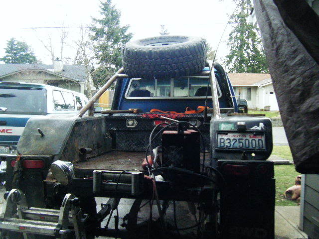

my flat bed is made out of pipe and is bent with a harbor frieght bender, i have taken many very hard hits including flopping on it and it holds up. only one real dent in the pipe.
i ditched my bed after i dented it so much i was embarressed to sport my sheet metal trophy
i would not suggest pipe for roll protection or sliders

oh yea cost me around $300 to make including the bender but i am cheap .... got remnants from the steel yard, poop pipe, and re-used stuff laying around to make brackets like this shackle bracket LOL
it just happen to work out good for getting started

That is a 1st class job. Materials alone would be $350+ depending on steel pricing and whether or not your went with the sheet steel or used some diamond plate bling bling.
I'd say $750 to $1000 range for the whole thing, as details cost money.

Actually no, I wasn't checkn the Pirate thread. Those photos were sent to me by Jeff at Badland Bumpers. Same guy I got my bumper from. It is to much to have a flatbed from him shipped here.

I would like to get more pictures of this truck. I'd like to build something like this. Is there anyway I can get more information about who owns this? More pictures, etc. ?

It's MT-TOY aka Guff's truck over on pirate,
http://www1.pirate4x4.com/forum/showthread.php?t=731323
