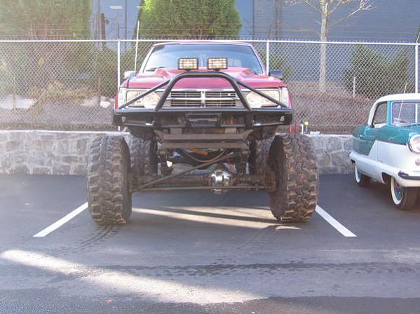

Hood
make you a hood like this i had clearance issues with my 302 fitting awesome rig man
Dont need it anymore with the 4.3 under the hood it sits about 4" lower I would say. Much better choice
