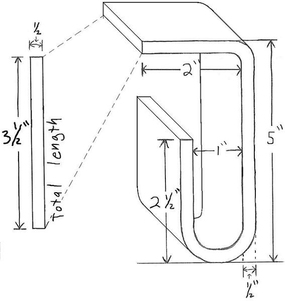

i have a design that i need made.
i was wonding if anyone can make it for me or if anyone knows someone who can.
i attached it.
im in arizona, so if you are that would help, but i guess its not required.

I was gonna say that would be easy to bend yourself until I saw it was 1/2" thick...

O my god! so what is that thing for? I will fax it to a local shop here for a quote for you (Michigan)

oh, and keep in mind, the tightest inside radius you can do with a bend like that is generally the thickness of the material ... so 1/2" radius
edit: in proportions

On TTORA he said it's for a light mount... If so - um, dude, my HEAVY skidplates are "only" 3/16" - I'm thinking something in the 0.090" range would be PLENTY stout.
Regardless, if you had a torch and a vise, you could bend it quite easily.

for a lighthouse?
if this is for your vehicle, let us know, I'd be glad to try drawing something else up for ideas

thanks for all you help. i was making it to hard and difficult. i got with a friend and we made something close to it with brackets.

k, got the quote back today, not too pretty

How many do you need?
I could cut one out with an EDM macine.
PM me.
